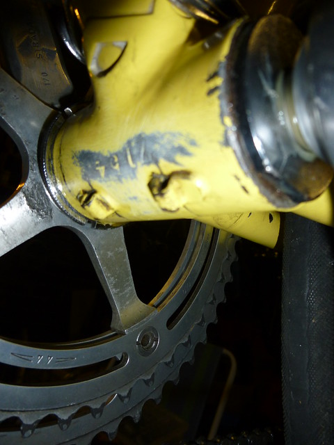

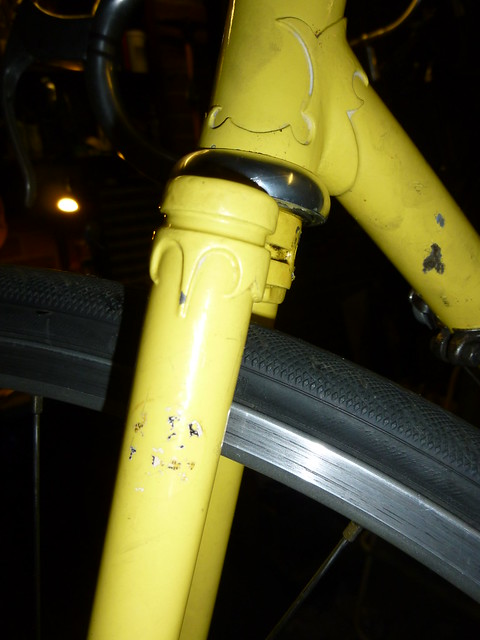

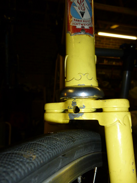

I took a few more pics this morning of the fork crown and the BB cable guides. To me, this detail looks to be earlier than 1970s; although I guess it could have been constructed with older lugs. The lug work is particularly nice on the forks with the lugs thinned down to blend with the fork blades. The cable guides appear to be rather rudimentary and perhaps an add-on.
I am told that the transfers are definitely from the 70s/80s and the frame does appear to have been refinished, although not particularly well; there is some evidence of surface corrosion on one of the seat stays that has been painted over - it looks stable enough so perhaps has been treated but it certainly does look as if it has been repainted.
So, the plan is to continue building it up with parts from the late '50s/early '60s as I had originally intended, and if it is subsequently confirmed that it does date from later then I'll just have to buy another frame. And some more bits!
By the way, the stem came from stock but but looks to be from the right era for the build.
