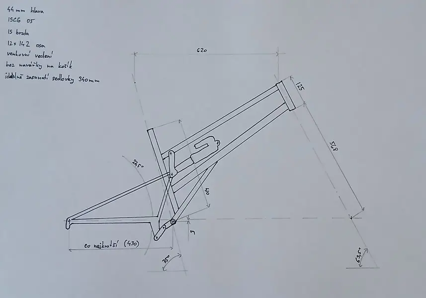

As I mentioned before, I wouldn’t mind shorter chainstays and a longer reach, but I’m absolutely thrilled with how the VPP works. It performs beautifully — it’s sensitive, hardly bobs while pedaling, and behaves great under braking. Already in the spring, when Franta Mrázek was making me a trials frame, I arranged with him that in the fall I’d bring him the Uzzi, and using the existing linkages he’d make a new front and rear triangle. A week ago, I gave him the frame with the shock and added a sketch. The frame design is just my own estimate — Franta will make it as he sees fit. But the shock mount sits quite precisely between the top and down tube, so it’s not really possible to use a classic design. The frame should be finished around the end of January.
