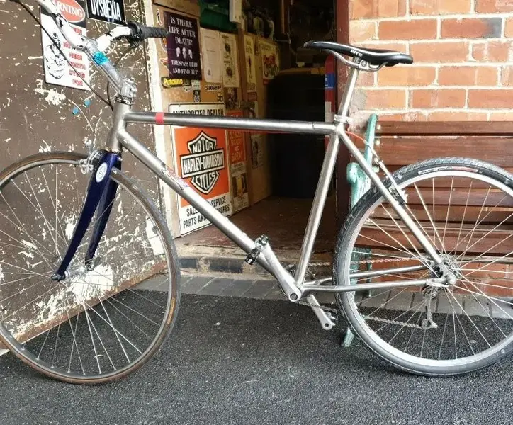

Some of you may have seen this Fisher Prometheus titanium beast on flea bay in late 2021, a total Frankenstein, check out the road forks & brake, trials stem, welded in seat post, patched top tube, drilled out cable guides......everyone needs a challenge right?
As advertised.....

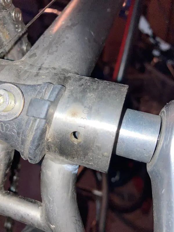

The Fisher Evolution system including 1-1/4 inch headset and 80mm wide bottom bracket were innovations back in 1989, the 140mm wide axle and even stranger aluminium tube placed over it were not part of the original concept, I have no idea what someone was thinking!!!

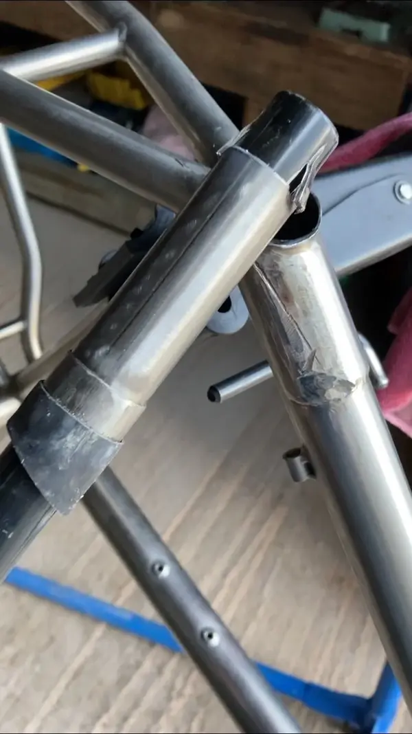

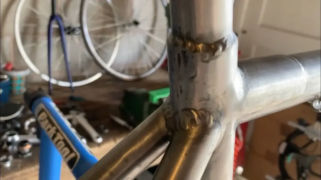

I can only assume major cracks had led the previous owners to weld the patch the top tube and then add an additional titanium fixed seat tube mast. This had been welded in, capped off with a solid billet of titanium onto which the saddle was loosely attached with a old style BMX clamp!!!

That is my old frame previously owned by clockworkgazz.
As Gazz stated, the original patch was damaged when he got it, so he took it to Vernon Barker to repair it. From there, that patch survived at least one other owner, who I bought the bike from. It was all good for a long time for me, until one day during a winter commute a pedestrian stepped out in front of me on High Street, Hull. In avoiding them, the rear wheel hit a hole where one of the cobblestones was missing and heard/felt a crack 😢
I notice the photo has gone from my thread, but I have a photo somewhere of how it cracked where one of the welds for the patch was. I stripped the frame and it sat with plenty of company in my garage until I had to get rid of the majority of the fleet before they went in storage as I moved abroad. I sold the Prometheus frame at a bike jumble for £50 (the same I originally paid for the whole bike delivered) to a guy who then told me he was a titanium welder and he went around looking for damaged frames to buy up. I have no idea whether he was the person responsible for the butchery that was inflicted upon it after that.

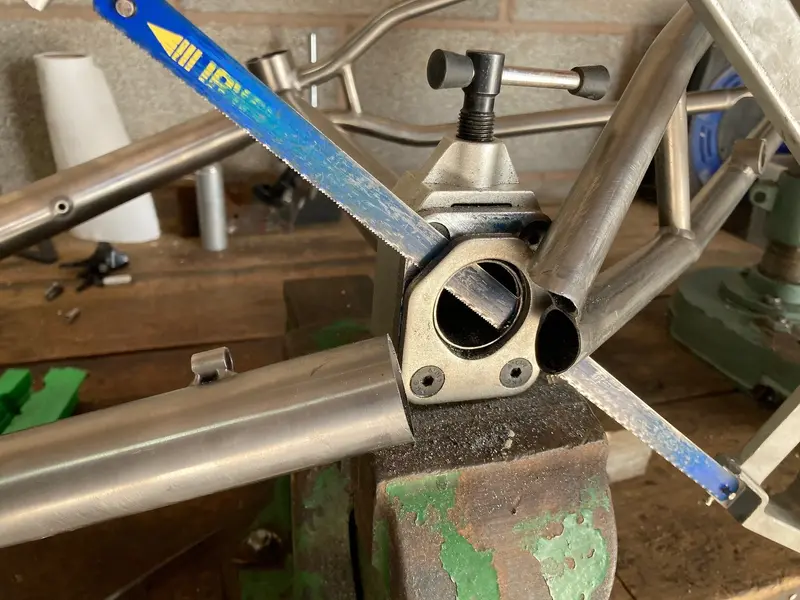

Part 1 - Hacksaw, files and drills
There was no option but to dive in and get the hacksaw out.....which revealed more rings than an oak tree!!!

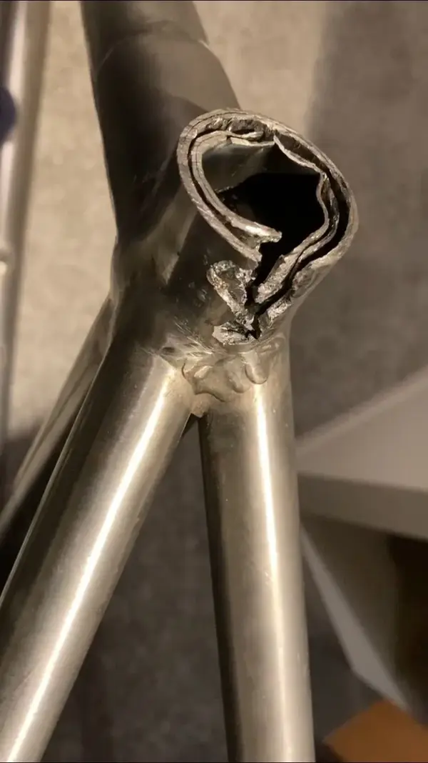

Multiple tubes had been inserted into the seat tube and all welded together. Time to remove as much of the weld as possible and then work out how to get the tubes out...looking worse before getting better hopefully!!
I made a tool from an old handlebar (in black in the photo below), and used it to hook the 3 extra tubes from the seta tube....

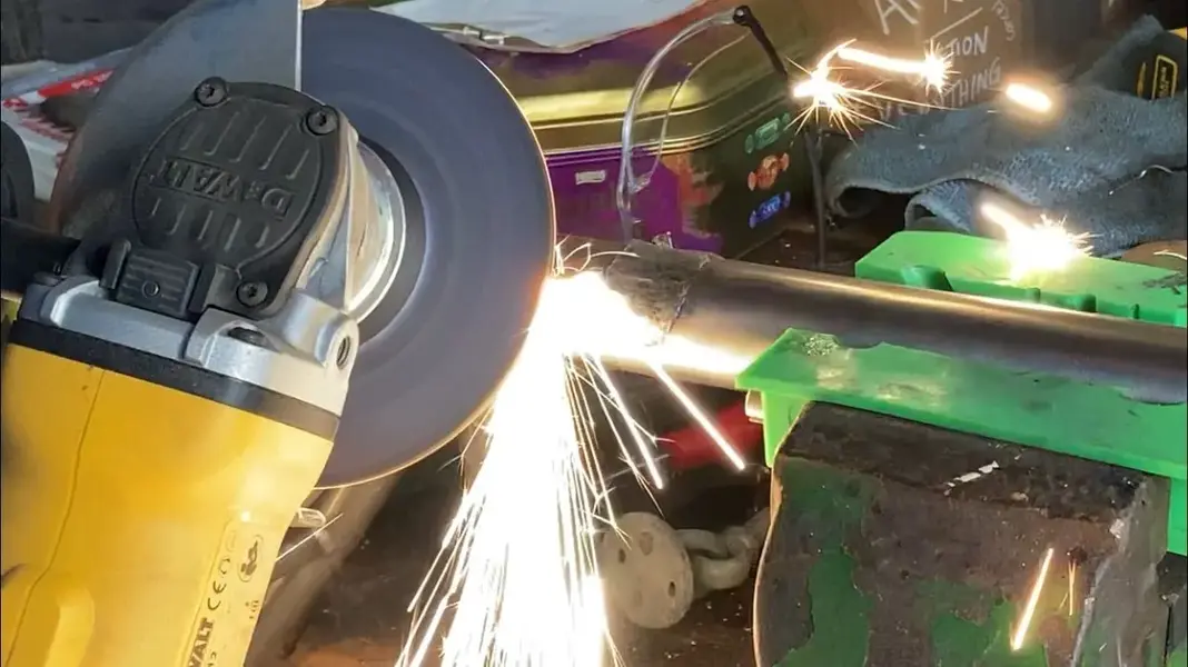

Now to remove the old repair patch to see what's underneath....go easy with the angle finder....

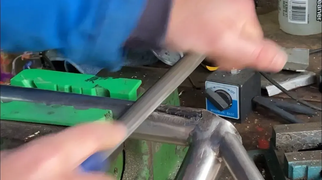

and then filing, in total about 40 hours of filing!!!

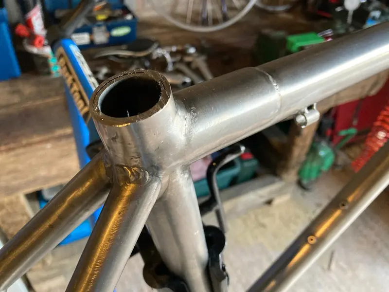

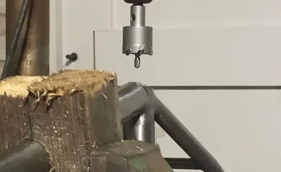

Next to remove the original seat tube, 31.8mm hole saw....
Worked in a fashion, back to the file to do the job properly....and after another 10 hours of filing and hacksawing....this is how it looked....

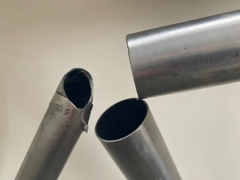

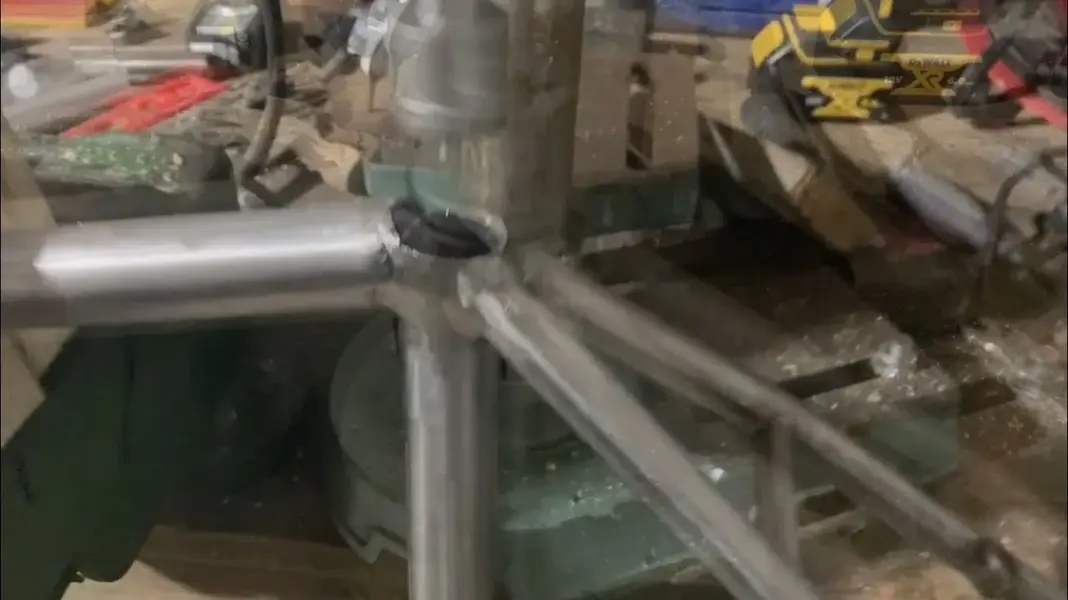

A bit more filing needed :) to tidy up the seat stays but I was beginning think this could be recovered! I though about replacing the whole seat tube and top tube but that would loose the original bottle and cable bosses, so the plan was to make repair pieces and weld them in. Originally I thought I would have to make some custom machined tubes to fit but Paragon Machine Works in the USA came up trumps with their standard seat tube inserts, so more hacksaw to cut to the right length....
More filing and then we have all the tubes cut to length and mitred by hand...
Bingo!!!!! Maybe a bit more filing????
Next time a bit more metal work and then time for welding, fingers crossed!!!!
