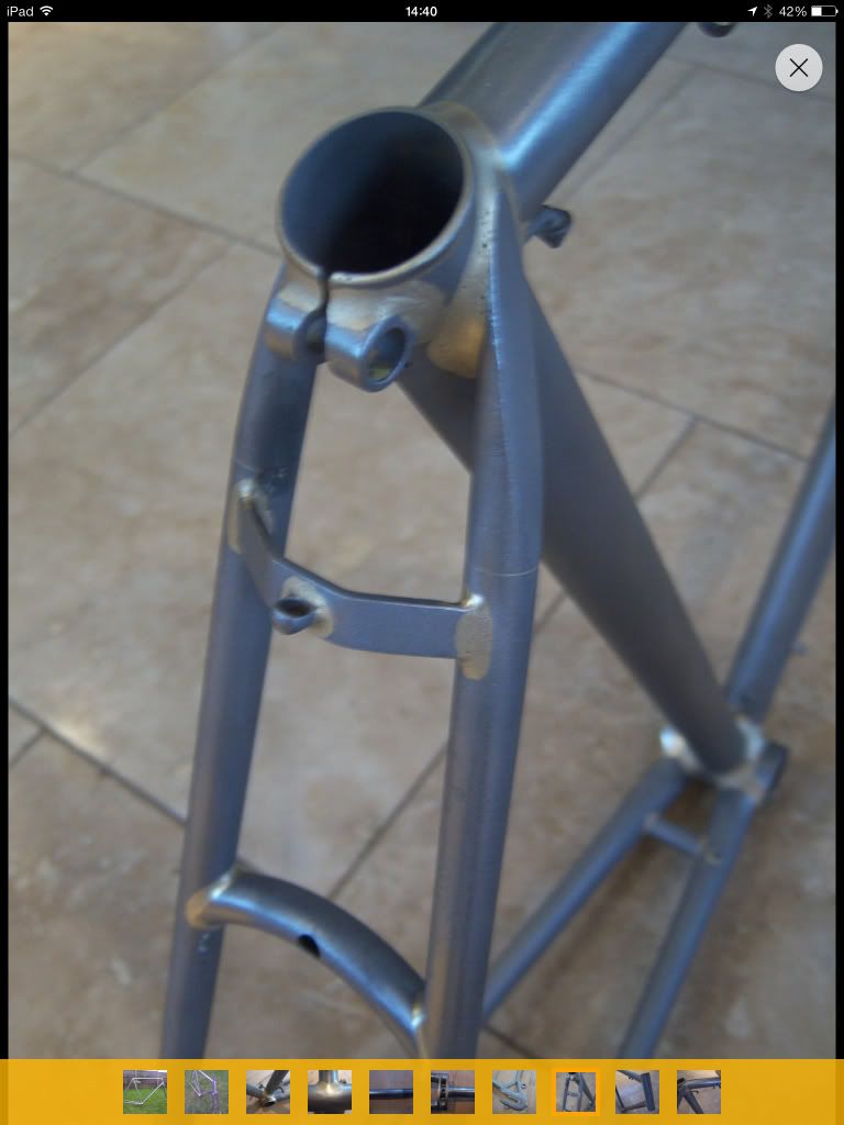

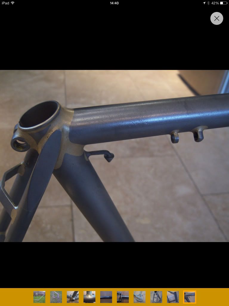

Just won this frame and fork off of eBay. Some unusual features caught my eye. Fillet brazed frame, numerous braze ons including a guide wheel for the cable on the bb, 27.2 seat tube and campagnolo dropouts. Plan is to get it finished at C&G and build it up as a leisurely bike to go out the pub, nice sunny Sundays etc with the wife! Done a bit of research but can't find any info as of yet. BB stamped 122, rear dropout and fork steerer share the number 1402.
Love to know your thoughts. Thanks
I must of spent 5 hours the past few days searching the internet for a similar frame, certainly looks of similar construction to some Claud Butlers and even some Mercians ( That would be a nice!) and it was purchased from Derbyshire! But I'm yet to see a frame that has the braze on cable wheel on the BB shell. Has anyone seen this before? And has anyone a bike with a similar frame number?

Here's a few more pictures but I'll take some more when I get the frame, hopefully on Monday. The seller did say there's a hole on the underside of the top tube, dead in the center.
Although the 2.75 inch forkrake is typical 1948/50, the whole frame now looks more like 1960, someone specified a long fork. Obvoiusly well made, and in good condition.
