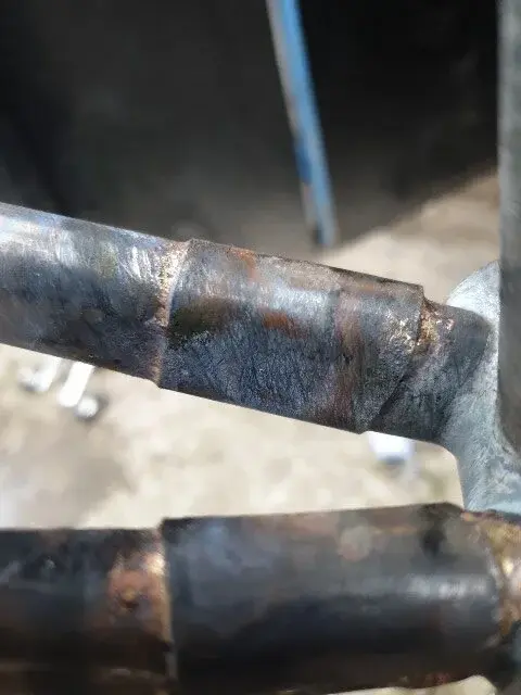

My main issue will be leaving adequate tyre clearance as I need to plate both Sides right at the "bulge" - double chainstay Replacement would exceed the frame's value, and he quite likes the 10 years of wear and tear
Crude but (hopefully) effective - ready to do the next 10 years🤠
