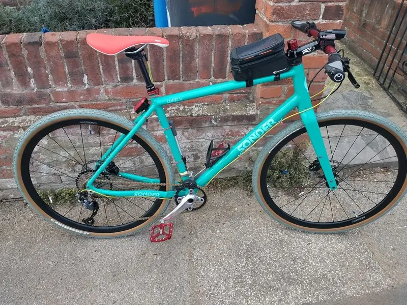

Flat bar gravel bike.
Moqi
Finally got this thing rolling. Still need to convert the tyres to tubeless (the tyres and the wheels are both tubeless compatible). My first effort wasn't very successful - tyres wouldn't seal no matter how much sealant was in there, so i put tubes in as a stop gap. the gears need fettling as they are a bit crunchy. It's a Sonder Camino Al - the crank is a xtr 960 that was jones'ed. It's running 38t at the front and 40 at the rear . It's got a dropper post as i've injured my hip/thigh. The tyres are panaracer graver kings - colour edition.

Looks great, how does it ride? Can I ask where you got the chainring from or did you modify the crank to take 104mm bCD rings?
It rides great. I had to change the cassette to a 10 speed 11-42 with a deore m6000 derailleur as i couldnt get the indexing right with the 11-40 9 speed cassette. It's become my go to bike - i've swapped the tyres to 43's from 38s and stuck mudguards on. In suffolk there's no mountains so it's perfect for the bridleways and footpaths that are the main off road opportunities round here.
I got the chainring from these guys https://garbaruk.com/102-bcd-round.html ... category=1. It came very quickly ( before covid) as well.
I'm pleased now that the gearings sorted and it's got mudguards. (still haven't converted to tubeless which is on my things to do list). I've also taken off the front chain guide as it doesn't need it - had no problems with the chain (rear mech is a clutch mech and the front thick thin.)

Is that a front deralleur on an x1 crank?
I like the look of ztto pedals too - are these bearingless?
not a derailleur but a chain guard which i removed when i went 1 x10 with a clutch mech. the pedals are bearings and du bushings. They were £15 off aliexpress. as long as you occasionally pump them full of grease for the du bushings they should last for years.
