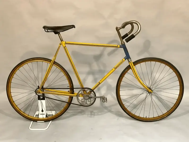

Looks like a winner, it’s in much better shape than what I started with. I would probably dismantle, clean, respoke the wheels, grease, replace the bar cork, and have the seat pan recovered. The paint is nice and aged, I’d leave that. It doesn’t look to have those 1 1/2 inch x 28 single tube tires so modern tubulars should fit. It’s probably worth the $1500. Two years ago you could find these for $500, five years ago $300. Count on a minimum of $1000 in repairs if you do it yourself, not counting any plating or painting. $300 seat cover on the original pan, $175+ tires, $40+ spokes, $25 rubberized cork sheet, $70 for wood wheel spoke nipples/washers and perhaps $250 for new rims if the old ones aren’t salvageable. This is assuming that the drive is not totally worn out. Looks good. Buy it and find a friend that will store it until you are in a position to work on it. You could dismantle it and store the pieces, perhaps even at different places. Someone has the wheels and someone else the frame. The bars and drive could be in a small box in you closet.

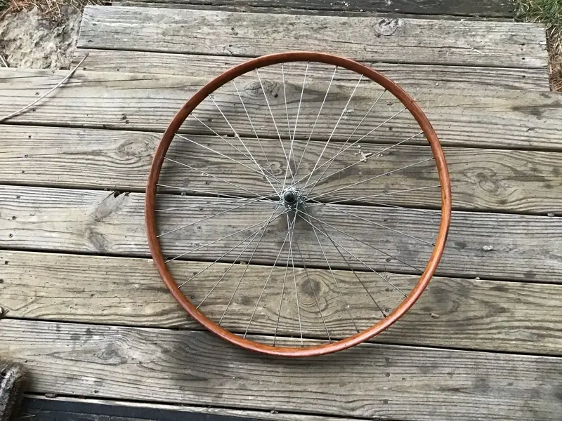

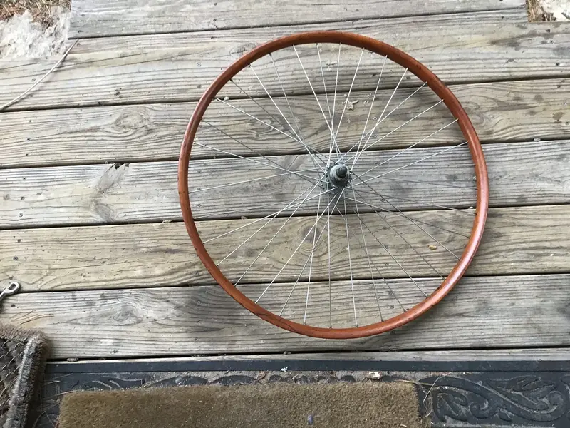

One down. It took awhile as deer hunting and some kind of flu like-illness kept me away from bike tinkering. I don’t think it will ever be perfectly round. Once you get it as good as you can the old warps begin to return. It looks like getting spokes 2 mm short was the right move as there are a few turns remaining to do future truing. The original spokes had two that were protruding beyond the nipple head and one that was out so far that the spoke was filed down. They even filed part of the nipple head off. Nothing is protruding now. I’ll not use these much, but I want to save as much as I can of the original pieces. A lot of money for basically a preservation. New bearings, new spokes, cleaning chemicals, bleaching chemicals, rust remover, stain, tung oil, epoxy, tire glue and new tubular tires. I don’t mind the work but I don’t like to think about the money. I’d probably have a fit and die if I added it up. 4D982E70-360C-4437-B45F-56C0C72AE77C.webp
One down. It took awhile as deer hunting and some kind of flu like-illness kept me away from bike tinkering. I don’t think it will ever be perfectly round. Once you get it as good as you can the old warps begin to return. It looks like getting spokes 2 mm short was the right move as there are a few turns remaining to do future truing. The original spokes had two that were protruding beyond the nipple head and one that was out so far that the spoke was filed down. They even filed part of the nipple head off. Nothing is protruding now. I’ll not use these much, but I want to save as much as I can of the original pieces. A lot of money for basically a preservation. New bearings, new spokes, cleaning chemicals, bleaching chemicals, rust remover, stain, tung oil, epoxy, tire glue and new tubular tires. I don’t mind the work but I don’t like to think about the money. I’d probably have a fit and die if I added it up. View attachment 683901
Nice work
Nice work
