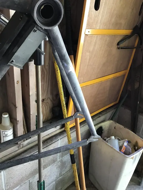

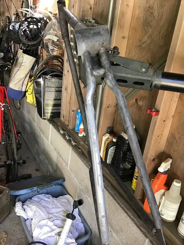

		Yup that's pretty much how I see itI'm going on this from p16, Woz. Your version seems to move the insert downwards to reduce diameter?
If I've got anywhere near the way this actually functions, then the top of the conical bore of the seatlug forms a 'shoulder' on which, (until the locknut is tightened) the threaded part of the 'insert' rests.
It cannot fall down the tube.
No part of the locknut is tapered in this scenario.
'Exploded' diagram:
 How they played the outer interests me with regards to the tubing being laminated with that dimpled or holed layer.
I think before nabeaquam starts the paint it might be wise to get this seat post collet system working sweetly....I hope the post is in good fettle! If the sizing is good which I think it's safe to say going by how the bikes made it'll work really well but needs to be so clean.
