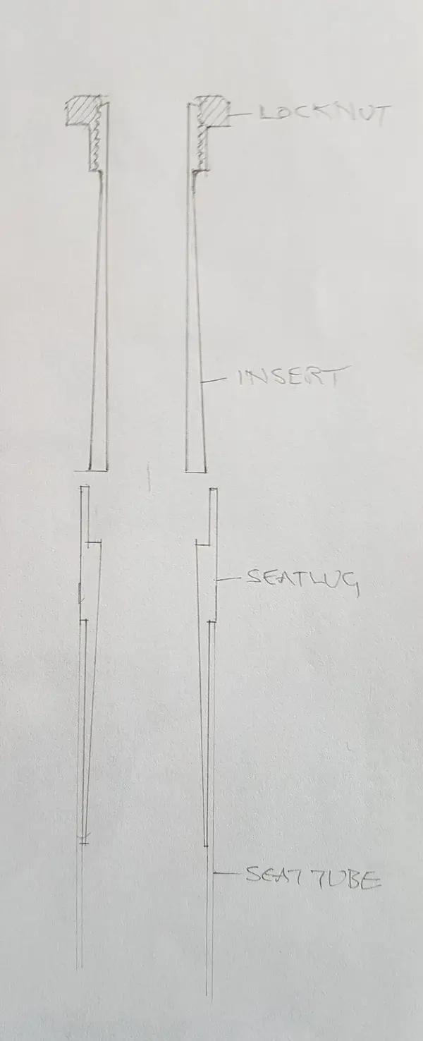

		I'd so like to get my hands on this for a good look and measure up! Intriguing isn't it!? Understated discreet yet brilliant...all steel 22lb bike..no aluminium...130 years old ....it just goes round and round in my head!A collet so slim that it has to fit within the couple of mm available between the internal diameter of a seat tube and the external diameter of a seat post? I reckon you could install that from the top opening of the seat tube, you wouldn't have to do it from the bb. It may not even be 'captive'. If the slots were wide enough to squeeze together to get it in, then it could be got out the same way.
Maybe the outer 'female' conical part of the collet is integral to the seat lug?
