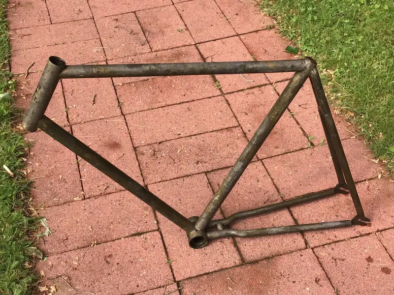

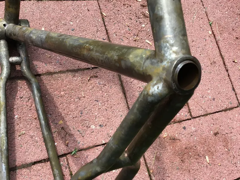

The heavy overnight rain brought my vinegar soak up so I only need two water buckets for displacement. The vinegar is removing the paint. I’ve never had that happen before. I wonder if it is enamel or lacquer? It’s chipping off like old lacquer. It comes off easily with daily brass brush scrubbing. The nickel over copper plating kept the frame almost rust free. The only pitting, or any rust for that matter is in three small places on the top tube. One more day of soaking will finish off the rust and what little paint that remains will be sanded. The paint is already scrubbed off the hard to reach places so it should be a snap. The wet scrubbing eliminates lead air born dust. I’ll wet sand what remains. Here are the only rust spots. CD5F3922-C4B0-4478-9FFB-4556A1A78FA4.jpeg FE276E2F-AD33-400A-B263-ADC218268C6D.jpeg 34B9BC23-75E5-4758-8D6E-A5F82374A40A.jpeg
Ooooh..your heading towards the clean work on frame ,looking good for a 130 year old!
Is the tube sticking out the top of seat cluster the collet?
Is there absolutely any "witness" off the dimpling showing through on the outside of tube?
That tube fascinates me ! 😁 I kid you not I do think about it! Haha
No, but it’s got double plating on it. More overkill, why not just paint. The plating may have been used as a primer to smooth out sanding markers etc?
Wow that's awesome I'm surprised you can't feel or see it... testament to the quality! I guess when it comes to overkill it's more to sell....kerching!
That seat cluster is so neat no slot no bolt very sleek...tis a thing of beauty 👍
Is the tube sticking out the top of seat cluster the collet?as
