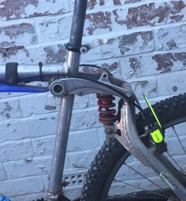

The STS linkage is a bit of aluminium at the end of the day. I'm sure someone could mill a replica with proper eyelets. Could be expensive, could be cheap. I've no idea but it has crossed my mind.
I'm wondering if it's a feasible/sensible idea to have a rocker made for my RTS that has a built in mount for a standard, or perhaps even a risse amp shock?
Feasible? Yes, anything is feasible with cash and time to throw at it, look at the moon landings or concorde or the Scottish parliament building.
Sensible? When has riding 20 year old recycled coke cans down hills ever been sensible?
I did see somewhere a guy who made a new lever for the lts out of plain bar stock and some nuts and bolts, lots of adjustment built in but proper fugly.
If you have access to a machine shop then it's just time and materials otherwise just ride until the frame snaps and move on.
Not the sts though, they belong on the wall. :-)

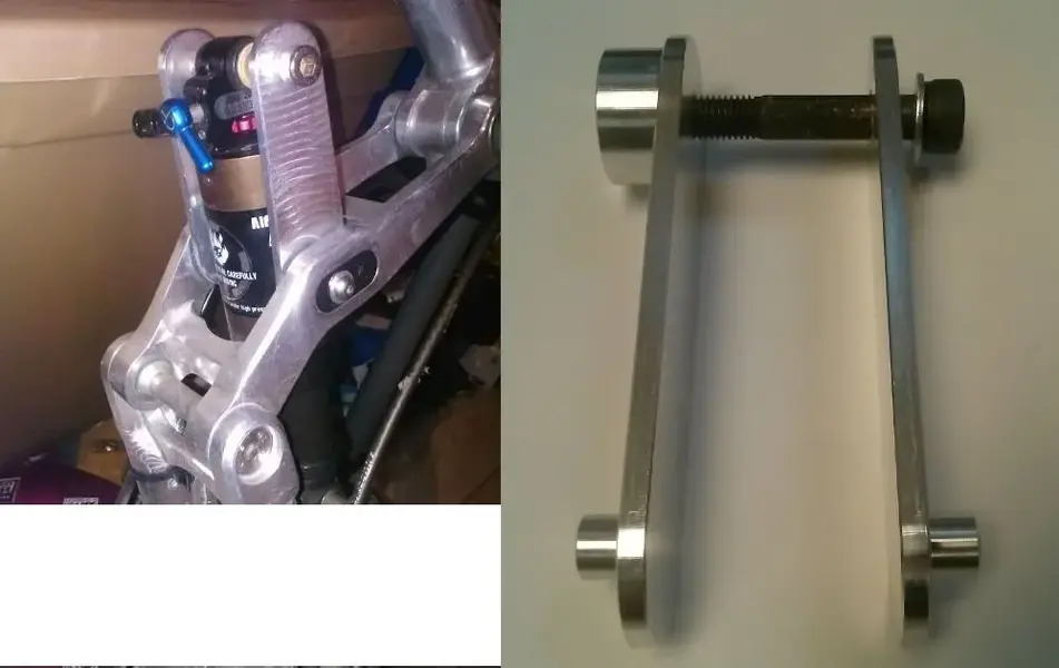

this I have given a lot of thought lately and with a proper (custom made) adaptor I think it can be possible
there's 165mm space inside the frame, so a "normal" rear shock COULD work.
and you don't necessarily have to go through the frame, you can also go around it with a yoke like the newer spesh bikes are using
There's an adapter available or knock one up. Shock size choice from 5.5 to 7.5 eye2eye. Only works if your top pivot is behind the seatpost. No go on my LTS 1.
That's the ugly adapter I mentioned before. Not pretty at all and ruins the look of the STS imho.
I thought about getting a specialized shock and having a shaft made to fit the RTS, but the shock stroke rules that out.
I'm not sure it's feasible to go around the seat tube, I'm sure an option will present itself one day. Or I may be able to afford a risse........
