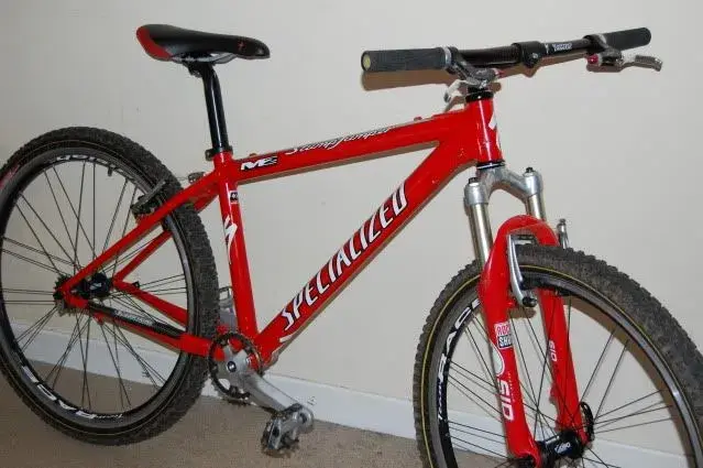

I wanna fit a BB7 disc brake to a pair of RockShock SID's what size rotor will I need?

What mount does the Sid fork have?
The Sid might only be warranted for 160mm discs, it depends on which year model they are.
steveonstumpy I'm not 100% sure but I'd say 160mm rotor with those forks, a RS Expert may confirm this
Looks like a standard IS mount so you shouldn't have any problems with the BB7, depending on which adaptor it currently has, adaptors are easy to source for IS mount and pretty cheap new, even cheaper 2nd hand

Theyre probably legit I reckon. Looks like they come with adapters for 'IS' mount like your SID has. The supplied rotors should be fine. If you fancy saving a few grams there are some nice lightweight rotors from a company called Ashima on eBay.
