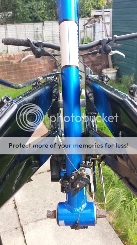

Yep, it changes the amount of travel - 4, 5 or 6 inches, and alters the head tube angle and BB height accordingly. . The QR makes it easy to use and I have never heard of one releasing by accident ( the whole area is really strong and the QR axle is about 9mm in dia ) - And in this day and age, anything like that happening would be notorious by now. :-)

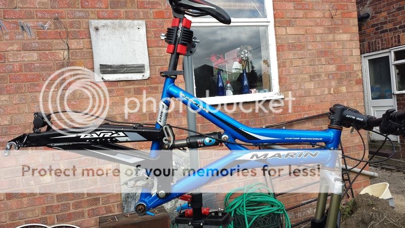

All the fungusy mouldy stuff had been wiped off when I got it and it's looking pretty good - just about to start work on it. Oh after I've ordered some cables...

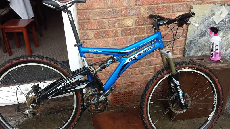

So not bad. Here she is after a cursory clean.
I'm frankly astonished so much of it still works - pleased and delighted and I was hoping for this but still more than a bit surprised I have so little to do.

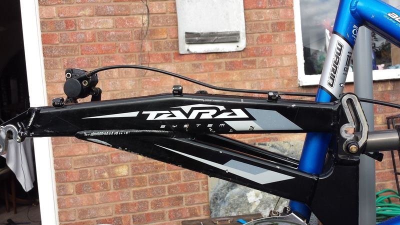

I was taking the bike apart and it occurred to me, looking at the ( fecked ) rear mech that something else was wrong with it.
It's a rapid rise.
Well at least it would have gone in the bin anyway.

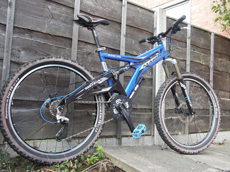

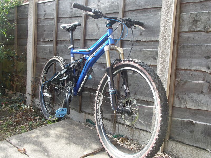

It's done!
After scraping off a lot of muck - ( a lot more of which had already been removed for me by the splendid Longbeech of this parish who picked the bike up for me ) and after fiddling about with stuff like oil levels and hydraulic disk brakes, and adding a few new bits I have my most modern ride yet:
Swampy, the Marin. I will be test riding over the weekend - I am off to the Retrobike Peaks ride tomorrow but in the interests of predictability I shall be taking the Rift Zone instead. So, Sunday will bring a short test ride just in case something hydraulic explodes.
All looks good though. :D
The only thing I am a bit unsure of is the damping level on the rear shock: It's on full but I can't tell whether it's enough, and I can't find a manual for it on t' net so I may end up either taking it to bits and exploring or taking it for a service.
I learned a lot on this build: principally about Disk Brakes, so thanks to everyone who gave me advice on those especially.

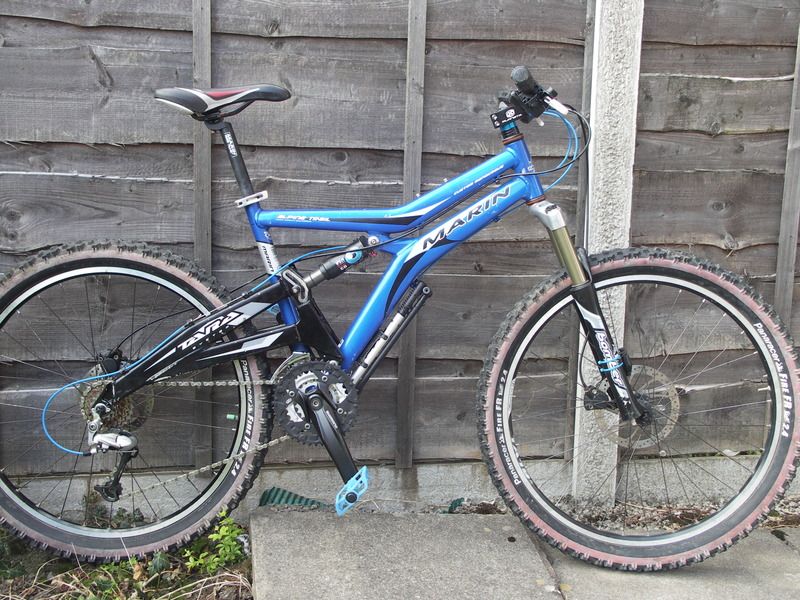

Here he is:
As you can see, I fitted a new Shimano chainset ( not keen on Truvativ and it was rusty as all hell ) new cable inners and outers, new rear mech ( to replace the hilarious backwards thing that was fitted) New grips ( I love the Ritchey ones ) there are new bearings in the rear wheel, and a new stem ( the factory fitted one was too long) and I gave it new cheap flatties, to see how I get on with them, and fitted some more modern shifters to replace the ones on the bike which were jnackered.
Surprisingly, considering the state of it when I acquired it there wasn't much that needed doing. The Tyres are fine although a bit sunbleached there are no cracks or anything.
I am delighted with it. :D
Thats looking ace 8) Its amazing what these things survive and how well thats cleaned up , Never ridden a full suss Marin , how is it on the climbs and fire roads etc ?
Paul
Thanks :-) I haven't ridden this one yet, but as far as the Rift Zone goes ( My other Marin Full Susser ) it climbs like a goat on speed. Great on fire roads and trail centres and everything in between. I imagine this will be even better - adjustable rear travel from 4, 5 or 6 inches and a full 4 inches of travel on the fork. Should be stiffer and the shock and fork should perform better. I am already a fan of Disks and I've only messed aboout with them so far :-) It has a more upright riding position too which will be ideal for the trail centre type riding it's been bought for :-) More info as and when I have it :-)
