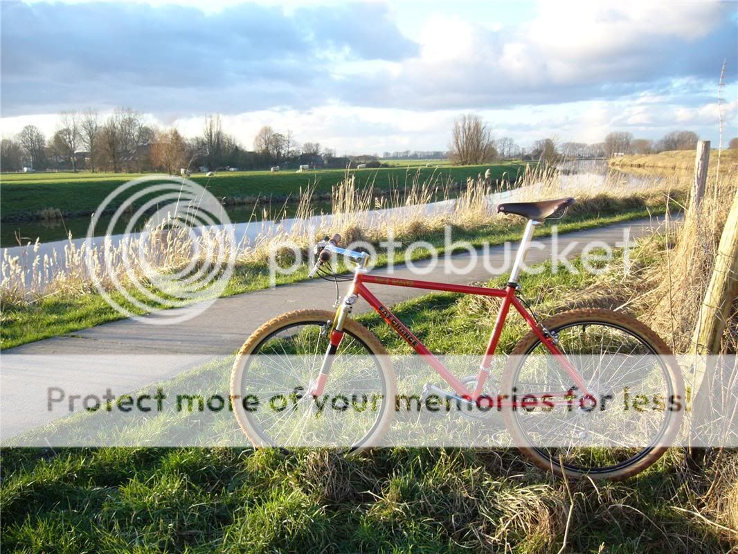

This is a friends Buck. It has the colour matching Judy forks. Grips and Brooks seat are colour selected with the tyres. Neat DX groupset was donated by cheaply acquired Panasonic MC-6500 donor bicycle (frame went to me :wink: ) The DX is not period correct with frame set, but I think it is still a more proper choice than '96 era XT or LX (I have nothing with those parts)
I am not a big fan of red, but I am fan of this one.
