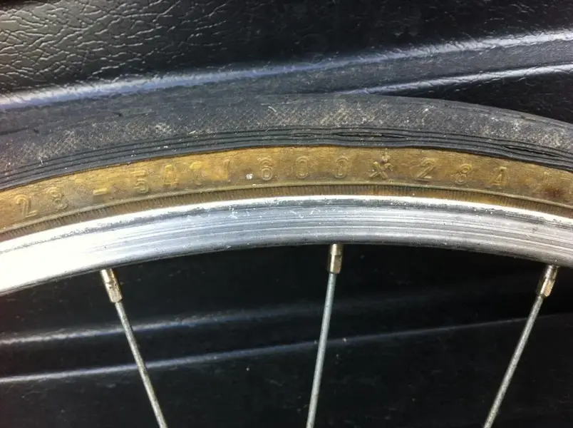

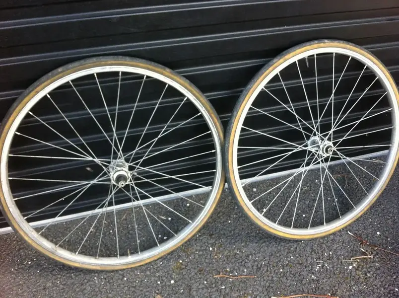

Sorry Richard it looks like my wheels arnt 650c but 600c????
Heres the pics see if you can make it out.
You are still welcome to them...
Stephen

Re: 2 bikes for the family - Peugeot Sportive + Townsend R L
No, those are 600A, not 600C....541mm. This is pretty much interchangeable with 540mm 24x1 3/4", mostly a wheelchair size these days, but loads of choice.
600c is ETRTO 520mm. Turns up on very low pro TT and track bikes, and Airnimal folding bikes.
Richard, give us a decent measurement from the dropout/axle to the centreline of the brake block and we can tell you which wheels will fit. Take this measurement and double it, then compare to the available ETRTO numbers...507/520/540/559/571/584/590/622mm etc.
