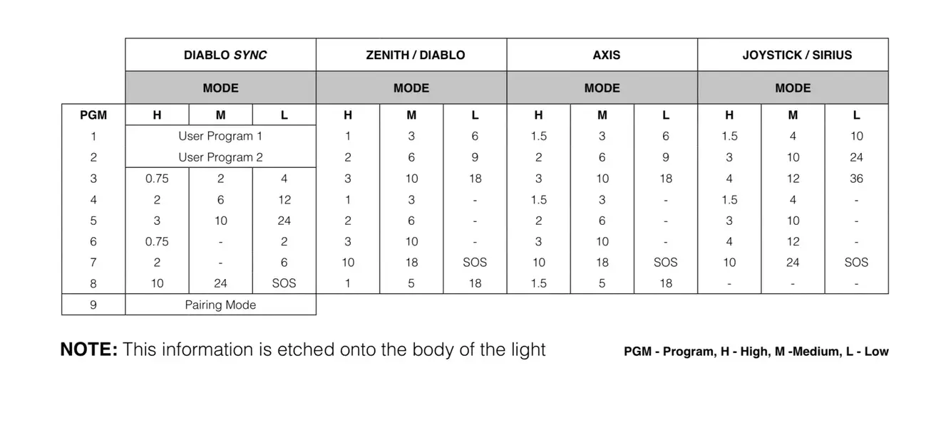

If you can find the instructions online it should give a table, the on the larger lights it’s etched onto the light itself.

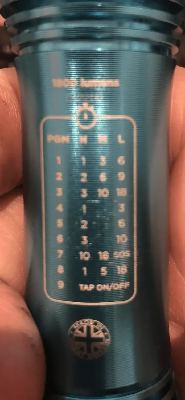

Here’s the modes on a Diablo.
