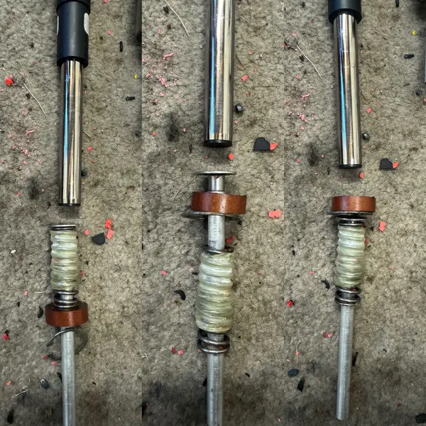

I’m rebuilding a set of Judy FSX’s with a pair of Englund cartridges.
I’m having a senior moment for the correct parts sequence for the lower shafts.
I’m aware i appear to be missing a couple of parts…possibly a spacer under the end of the cartridge which sits on top of the lower shaft (would a standard judy top damper plastic spacer work? and a nylon/rubber spacer under the burgundy part that sits in the lower part of the stanchions held in by the circlip)
Anything similar i could use and if so i’m guessing an ID to match the lower thin shaft so it’s not flopping about?
So they came out as the 1st pic (let’s go left to right as 1/2/3) I did a dry build as they came apart and seemed to work fine but i’m probably over analysing now so which is correct.
Any help is muchos appreciated

if you wouldn’t mind, i’ve seen the seal kits already and the basic 2 page instructions on setup but doesn’t really give me the info i need.
