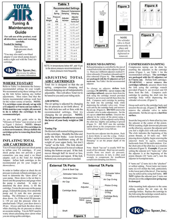

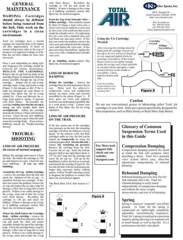

The Englund carts are serviceable. Just o rings iirc. They did have replaceable valves to create different damping too, if you've not got these you are limited to whatever is in there. Might be fine for you though.
Sorry, my bad. Englund is correct. I have a terrible memory for names! Anyway I know there were a few early air forks that used them as OEM (my old Judy among them). I'm just trying to get a bit of knowledge on the internals and how delicate, finicky, or robust they might be before I go tearing the thing apart.
Yeah, that is very useful! Not quite what I was expecting, but did answer all my questions and then some! Thank you.

I think it's SRP that sells the O-ring kits for them if need be. The ones in my Judy SL are amazing - they hold pressure for months
