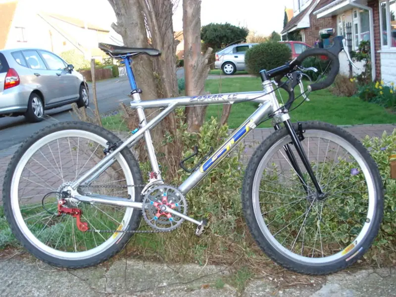

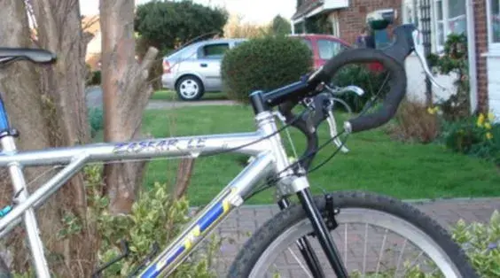

And they make great pre-gravel gravel bikes, here was what I was riding around 2006 for long on-off road rides
And this was basically an Exocet Missile out and about
This was fun in the woods
I was using drops on MTB as far back as 1993 for no reason other than I couldnt find a set of bars at the time :mrgreen: so made my then Karakorum into a monster cross
