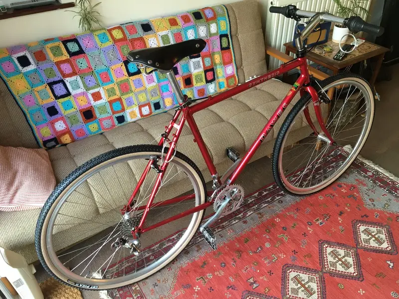

I considered Vs for ease of setup but in the end have gone for some Tektro CR720 cantis which are on their way to me - a modern touch but very retro inspired and it means the rear cable hanger gets to fulfil its destiny.
This definitely won't be going 1x and as comfort is a priority it'll probably keep the saddle (or something similar).

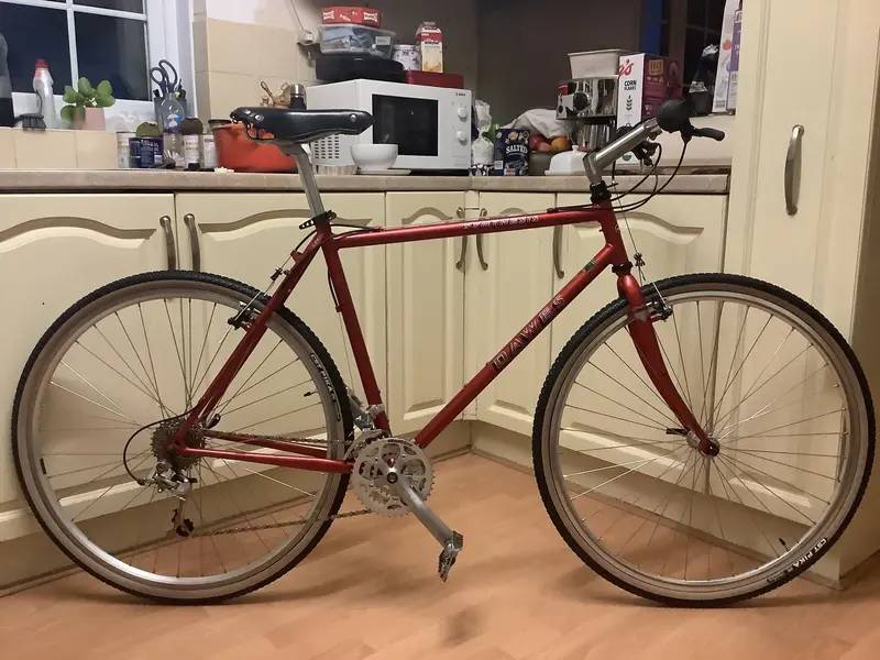

I've already hopefully saved quite a bit of weight over the original spec which was altus with a horrible crankset and lots of steel bits (bars, headset, etc.) but in truth the frame and forks are both pretty weighty so it will probably always be a bit of a lump.
Still... Could lose a bit of weight with a wheel upgrade, 2 of the chainrings are steel etc... Lets see how it rides and then I'll consider upgrades.

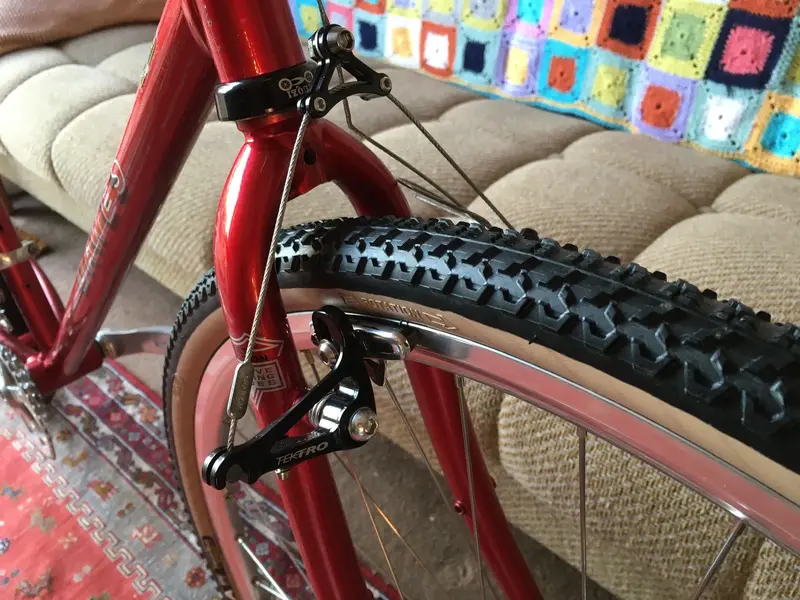

The Dawes build stalled because I couldn't get the CR720s set up satisfactorily with the Dia Compe SS5 brake levers I planned to use, also had issues with brake pads/stud position etc... After a fair bit of messing about I've decided to use some generic low profile cantilevers. Hopefully it'll be in action soon - I will post once I've made progress...
Captain Stupido
I used those CR720 - they do stick out a mile but worked very well,
I do like them and they look fab... I decided to persevere with them and I think they're going to work OK.
The hybrid/road style forks are narrower than typical MTB forks so spacing from boss to rim is narrower.
The standard brake pads were causing them to stick out even further than "normal" (ultimately reducing mechanical advantage) so I ended up fitting some road cartridge pads which are better suited to the setup.
The SS5s are not ideal for such wide profile brakes being designed for and having mechanical advantage better suited to low profile cantis so initially the braking power was marginal.
It'll need a road test to prove it but the setup feels OK now, if not maybe I'll try some different levers. The rear rim is wider than the front so that's possibly more critical...
Assuming they're done it just needs a chain and gear outers. :)
