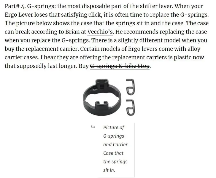

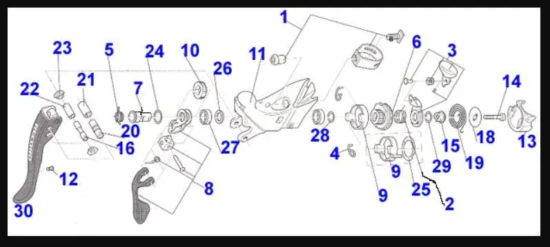

Just having a read through this...http://www.standardbikerepair.com/campa ... arts-list/
I think it might be Part #5. Finger Shift Lever Return spring
That's the later version although the parts that fail are pretty much the same and the parts that fail are usually #4 (springs) and sometimes #9 (carrier)

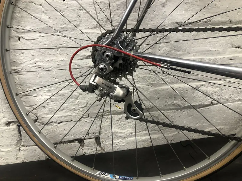

Well, you were both right as it happens……
As soon as I fitted the 8 speed Veloce rear mech this afternoon things made a lot more sense although the return was still jumpy… culprit in the mech was indeed a knackered “G” spring (No4)
Thanks Gents….
