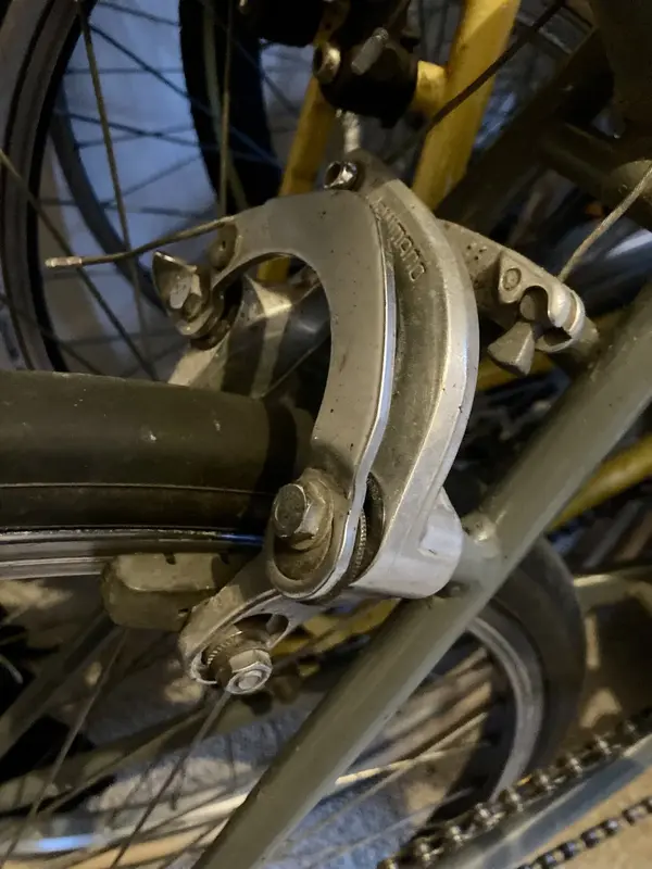

Lovely bike by the way. Nice M730 kit. Have the handlebars been replaced? Looks like they’ve got a moustache profile, but I might be wrong as they might have just got a lot of sweep?!
Great observation. What is difference between M732 and M730 pedals? Can't see the differencePedals are M732’s. Not the beartrap M730’s.
Brake levers are Dia-Compe SS5’s, they would have been 4 finger M730’s?
Good to see original XT brake pads upfront!
And my eyes weren’t deceiving me. They were moustache profile bars…
Those XT pedals are the comp version of the smash your shins bear trap pedals they did in 1988 and 89,i think there coded M731 could be wrong though, the code is stamped inside the cage.Great observation. What is difference between M732 and M730 pedals? Can't see the difference
Yeah the moustache.. I will change it to flat once I get
the sad thing is after 1-2 days I just got respond from the seller that the bike has been sold to another buyerThose XT pedals are the comp version of the smash your shins bear trap pedals they did in 1988 and 89,i think there coded M731 could be wrong though, the code is stamped inside the cage.
Going by the parts the bike looks to be from 1988 because straight away i see it's running the M730 Deore XT 6 speed cassette and white label M730 Deore XT rear mech (1989 they went to 7 speed with the M732 Deore XT ll groupset)
The gold label RM20's are from 1988 because my 88 Pine Mountain had them i'm sure it was 1989 Araya went with the yellow and green label for the RM20's.
The coolest bit from those Shimano Deore XT parts for me is that Biopace chainset, i've never seen a black Biopace chainringed 1988 XT chainset before it's always been silver chainrings. I've seen and owned the yellow label Deore ones but never the grey label XT one.
I love everything Deore XT so that alone would make me want to buy that bike lol
