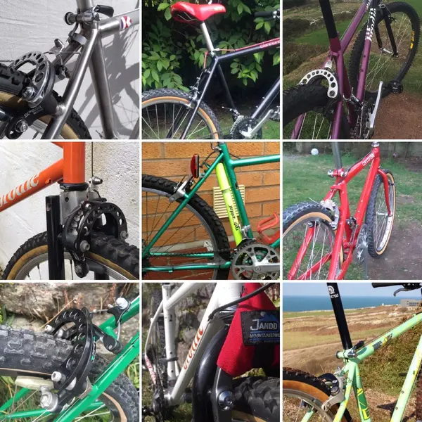

Sure they clog a bit in the mud, especially mounted on the chainstays, but it's a small price to pay for something that powerful and awesome looking. Maybe not ideal for our mucky winters here in the UK but then a fully rigid 30 something year old bike off-road isn't ideal for my forty something year old back :lol:
I'm a big fan!
