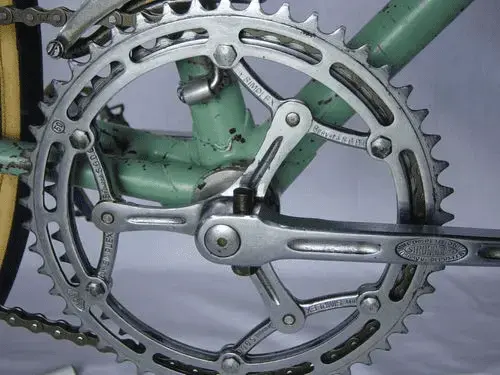

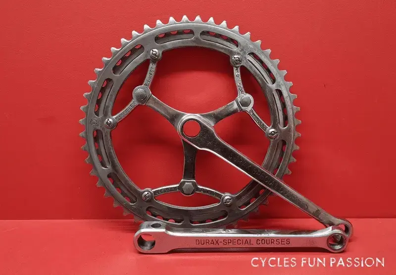

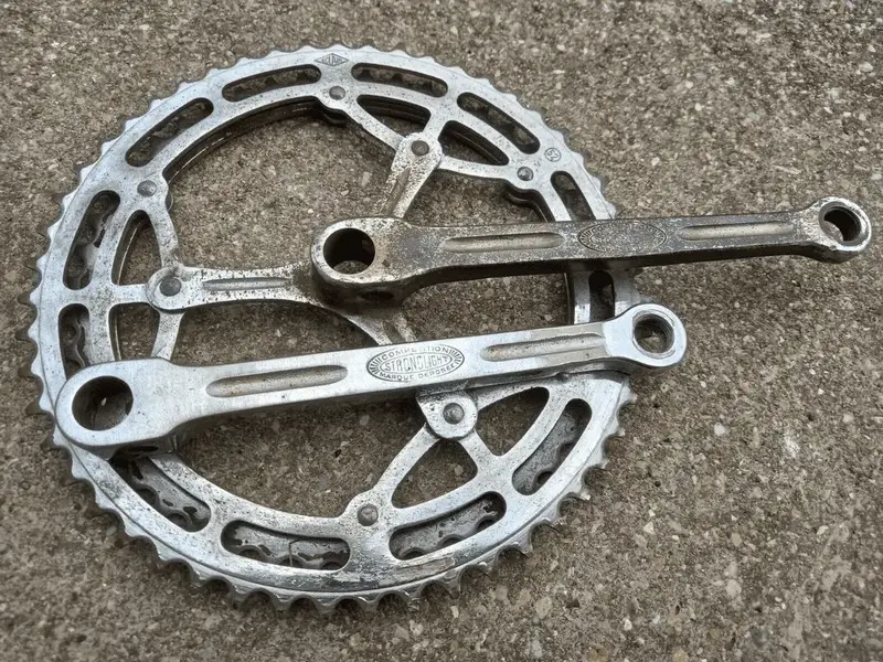

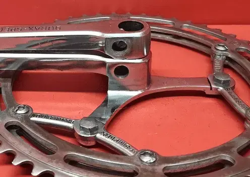

Your three arm crank has a different maybe early Stronglight stamp so maybe originally for a single ring. The 54 & 55 cranks in the 58 catalogue states compatible with both single and double rings so probably a greater distance from the centre of the cotter pin to face of the spider. Need the distance on a 54 or 55 to check against yours, a message to the seller on eBaySpacers on the three arms will work but finding longer bolts could prove tricky
I swear I have cried blood from my eye balls over this. There is most certainly a specification change of these cranks over time exactly like you say, and the few photographs of original builds seem to confirm this. It's hard trusting some sellers who cobble anything together.
Basically looks like they widened the drive side part that sits on the axle - the crank I have the cotter pin sits half way between the spider and edge, but some I see there is a slightly greater distance to the left (inboard DS) towards the spider.
