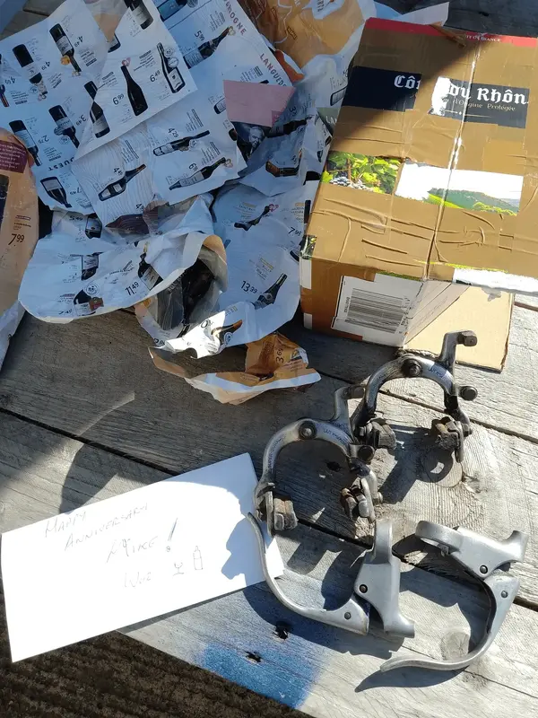

Yeah, I get what you are saying. The original brakes are now with @Mickeyspinn - he'll put them to better use than me.
