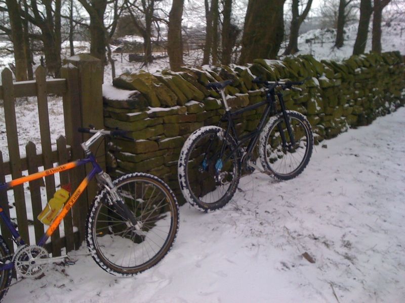

1995 Smokestone with hs11's, capable of running up to 3" tyres on 26" rims front and rear thanks to girvin vectors also can run 700c wheel on the rear,
this was on the last nw ride, 2.5 supper tacky dh bonty's,
a very versatile frame.
