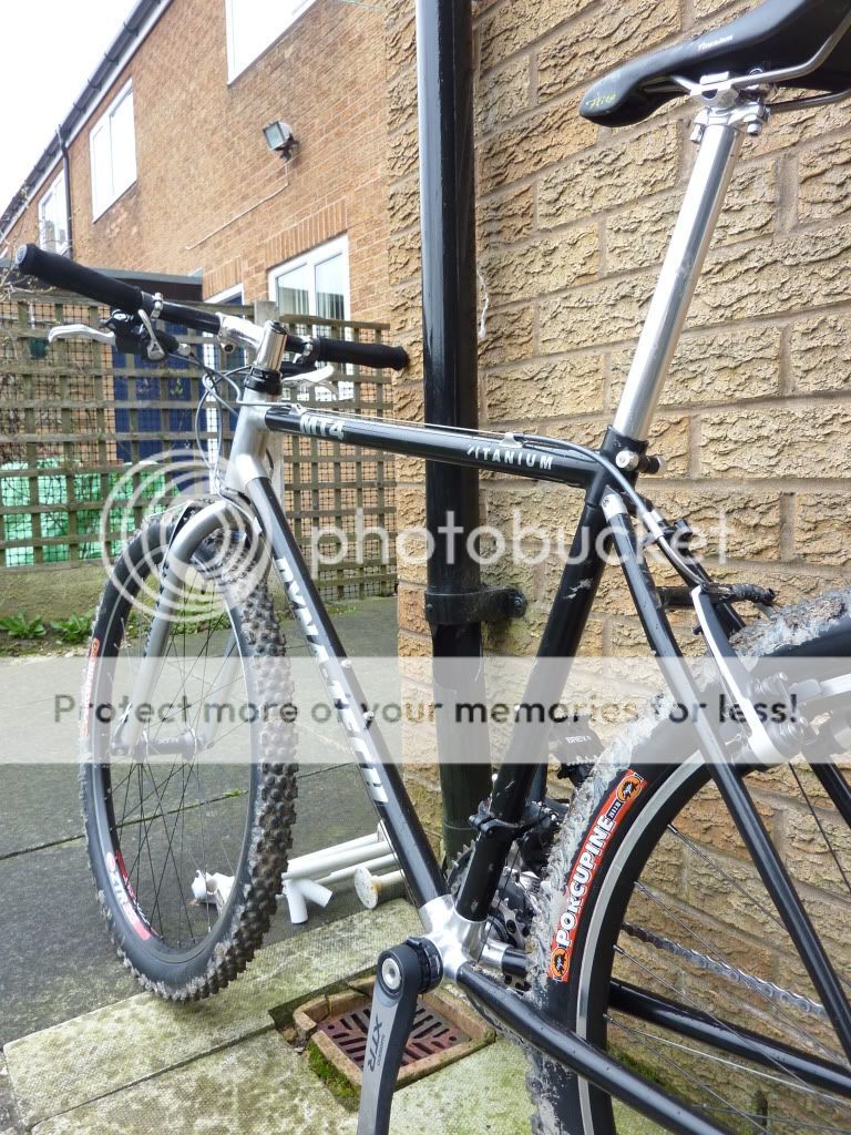

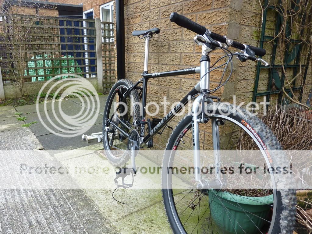

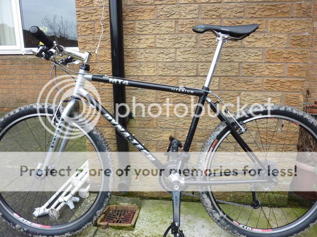

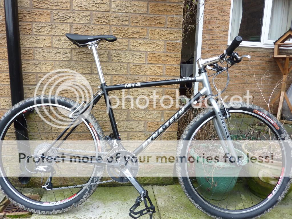

i had to spray over the decals because they would of been ruined if left bare so i masked them off and give em 6 coats of laquer
ive been out on it since my last post too ,nothing too strenuous but did a bit of stunting locally , a couple of hundred bmx style hop backs on the back wheel just to test the integrity of the repair on the seat stay and it seems to be fine
tubes and lugs are still intact after a bit of single tracking :-) , i will report back when iv taken it up rivington for a good going over
finished it with a non retro full xtr m970 groupset inc hubs , new retro style flite saddle , it weighs in at 20.8 lbs so i failed to make the sub 20 lbs mark i was aiming for but man this ride is super smooth and is like being on a race horse i am well pleased with it , heres a few dirty pics ,sorry i couldnt wait ;-)
cheers :D
