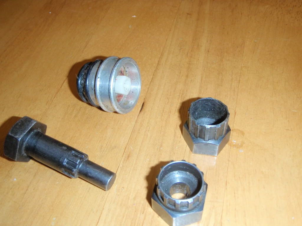

Was just thinking- You may have an early Dura-Ace 7400 series hub. These were uni-glide...a slightly shallower spline pattern lock ring than the now ubiquitous hyper-glide...(See photo)
Also pictured are the dedicated pre-97 dura-ace removal tool...and a morningstar freehub buddy....
This tool was was used to inject solvent (gt85)... and then very light shimano grease into the freehub body...

the tools i have are the one like the deep one shown on the right of the photo above. this was originally
a DA 7400 freewheel removal tool. i also have a weird looking shimano tool that looks like the shallower
version shown in the photo but it has a thin spindle joined to the middle recess of it to guide the removal
splines into place with the lockring. neither will pass that cone flange.
