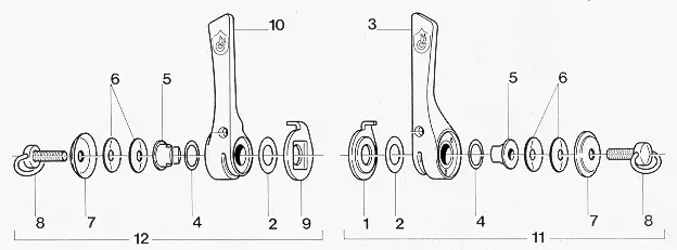

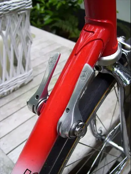

Simplex Retrofriction was mentioned by the Op and they don't index or ratchet, the Campagnolo I have shown are similar in action. I have used Suntour and they ratchet when pulling back on both left and right sides. I currently use Shimano 7 Speed switched to non indexed setting and there is a 'click click' both directions and it's only on the driveside as requested by the Op....l guess it all depends on what you're into really..a bit of 'click click' in one direction..or you could go both ways ...or just a bit of 'light action' only..😋...l don't mind a bit of indexing now and again..😮
Technically the Campy Syncros, even though designed for indexing, were "retrofriction" if you used them in that manner.
No wishing to split hairs or be argumentative, but I don’t this statement is quite correct. Syncro 1 and 2 could be swapped between indexed and friction mode but the friction mode wasn’t ‘retrofriction’.
