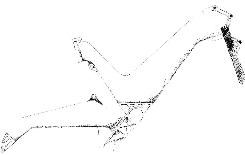

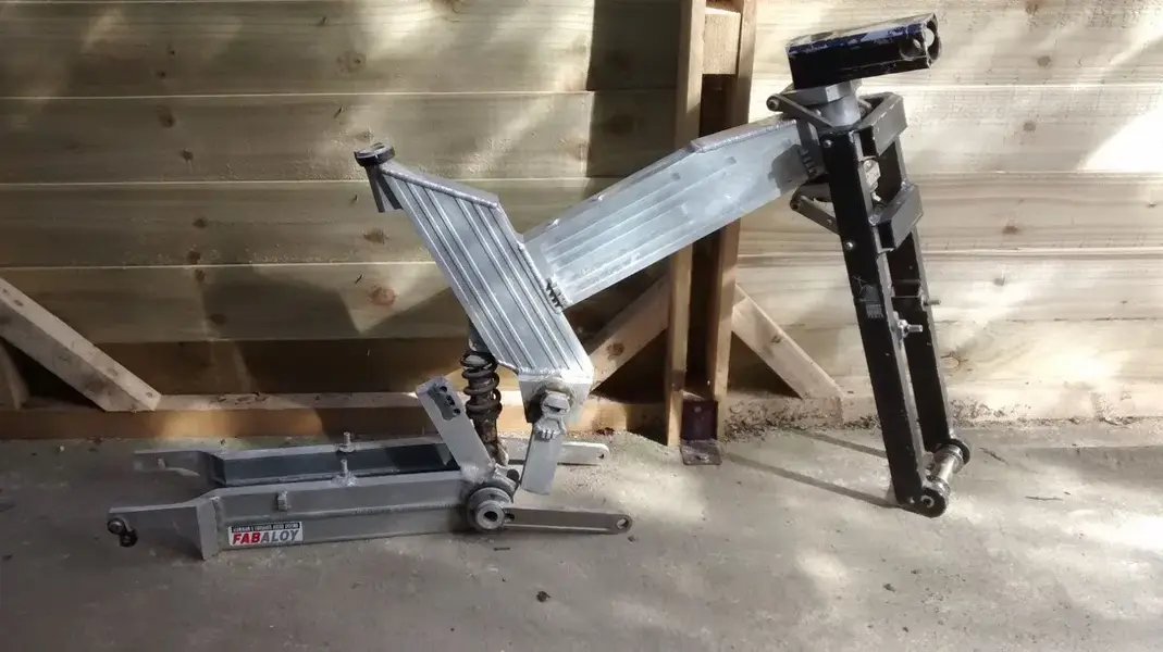

This is what i did for may degree.
Original concept & finished frame after being snapped.
6061 Alu frame and forks, Ti front hub, Ti fork linkages, Ti Cranks.
