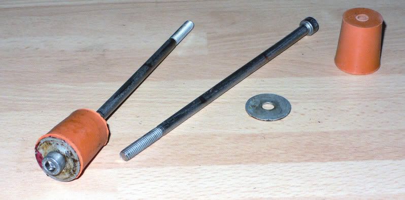

Having championed the 'Wings' spring kits on here before, and finally got around to sorting out at least one of my forks, I decided to give the lack of damping issue some thought...
Developing the long-travel conversion idea, the link to which was kindly posted recently by Ben...
http://206.75.155.18/kmr/manitou.html
...I bought some 30mm longer stainless allen-bolts and a couple rubber bungs with a 5mm hole. Using the original internal washers I came up with this;
...which I reckon is going to be just dandy...
I've also bought a Manitou M-Sport fork (see above link...) so that I can convert them to 100mm travel with some extra springs and even longer bolts (180mm as opposed to the std 120mm - the bolts pictured above are 150mm...)
I'll post photo's at both stages and report on the improved response in due course...
