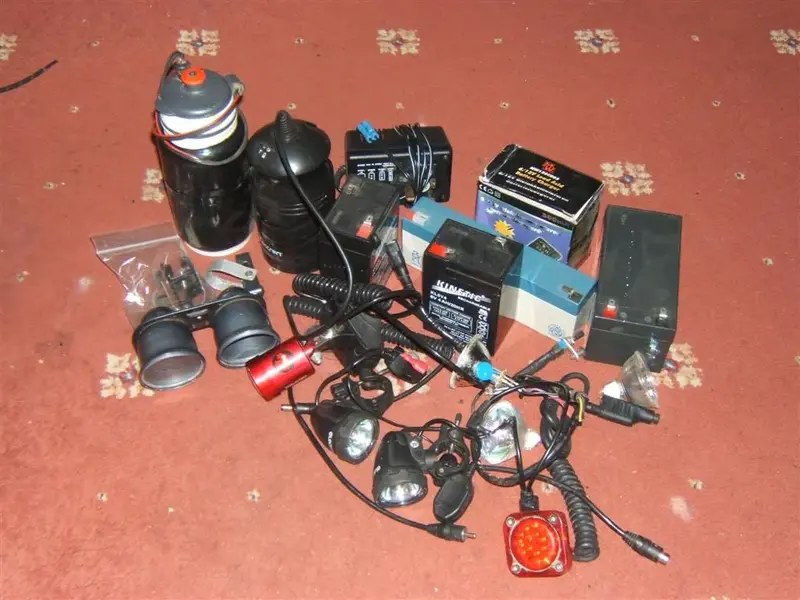

I've got a pile of stuff lying around.Nightsun,Electron and a BLT single 15w on helmet mount,plus 2 bottle batteries,2x6v sealed lead acid and 2x12v ones too,though given the size of them are pretty useless for using on the bike :?
The electron[10w+5w] is working and i use that.The BLT is complete but needs new conecting wires and the nightsun is just a shell.I was hoping to at some point come up with some sort of super powered LED triple lamp using the dual shell of the nightsun lamps with the blt becoming a headlamp.
I want to drop the heavy sealed lead acid batteries and use lithium ion or nickle metal hydride batteries to power it.
Im ok putting things together but its the electrical stuff i know nothing about :?
Therefore i haven't actually built anything yet
