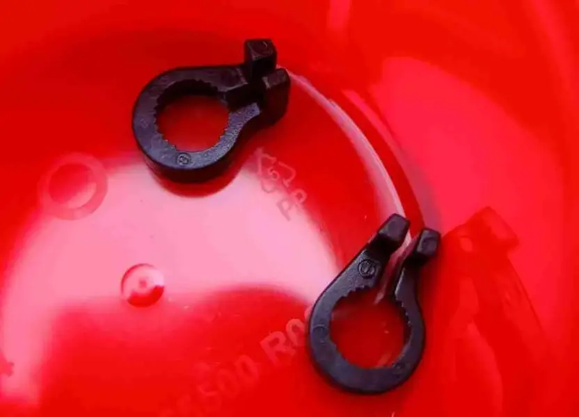

Ended up with these little bits left over... any ideas?
