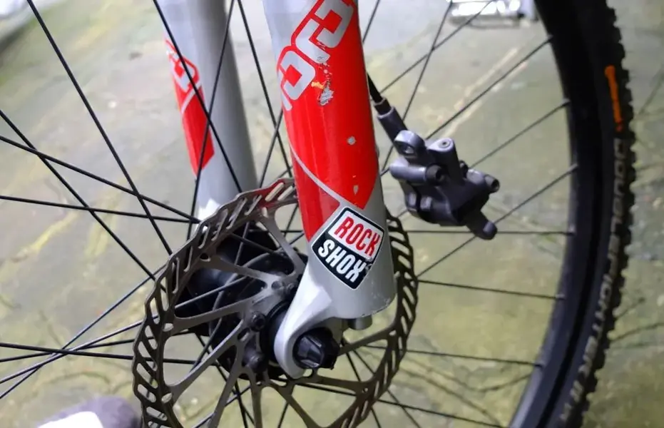

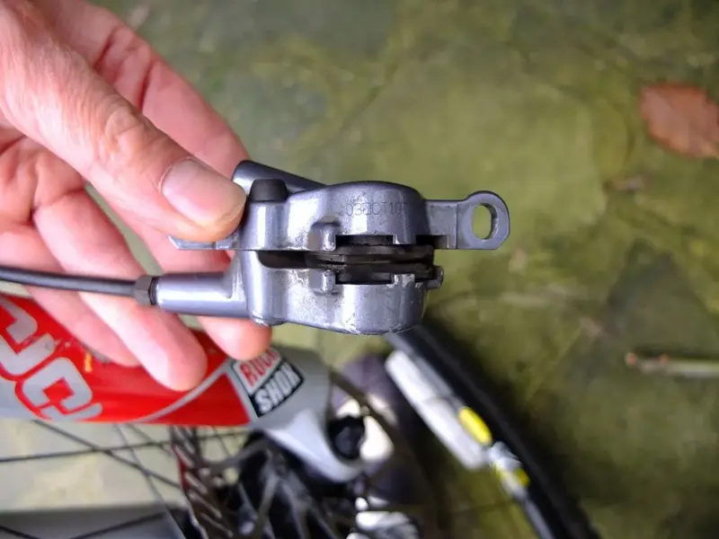

I picked this up locally fairly cheap a few weeks ago. It's the most modern bike I've ever owned, I think. The front caliper was hanging off, seller said it just needed new pads and he hadn't got round to it. I wasn't convinced...but at the price thought I'd take a gamble. They are Avid Elixir 3 brakes...the only hydraulic brakes I've worked on before are in cars or on motorbikes.
Ordered pads and new bolts. Attempted to fit and first of all realised I'd need spacers/washers too... Had a go at fitting the pads anyway following online instructions. The trouble is that the pistons seem to not want to go back - I used a screwdriver with the old pads to push the pistons back but they didn't move much. When I fitted the new pads there was only a narrow gap - not wide enough to leave space for the disc. I tried removing the pad and using a tyre lever directly on the pistons but no improvement.
Other than that they seem to be working as they should. What next?

take the pads out and use the centre bar of a cone spanner or something similar, couple of MM thick and ~20mm wide.
Trying to push pads in with point loads (screwdrivers, tyre levers etc) just makes them jam up in the bore (it's a *very* tight clearance).
You'll need to push quite hard and square to the axis of the piston. You'll also need to make an effort to hold the other piston in place while you push!
If you still have issues, the system might have been over filled. Just crack the bleed nipple open 1/4 of a turn and try again.
If the caliper needs loads of washers, you probably need this
https://www.chainreactioncycles.com/se/ ... prod110395
Or, in a pinch you can use those conic washers you used to get on v brake pads.
BTW, avid elixirs are probably the single worst hydraulic disc brake out there, do not invest more than the ~7 quid for the bolts on them. You can get a pair of shimano non series brakes for ~100 quid.
I've taken brand new ones off and either sold them or thrown them away rather than deal with them.
Sounds like the brakes might have been bled with part worn pads fitted, now the new pads are fitted the extra pad material has reduced the gap for the disc to fit in, as above try cracking open the bleed nipple slightly as the system may just have too much fluid in there to accommodate the new pads and the disc in the same space.
Follow mattr's advice re: pushing the pistons back in the caliper, but while the pistons are sticking out a little try lubricating them with a little brake fluid.
Good luck getting them to work 100%, newer Sram/Avid brakes seem to have improved, but I think every set of Elixirs I've ever had/touched/seen have had issues of one kind or another.

Thanks all - brilliant advice.
