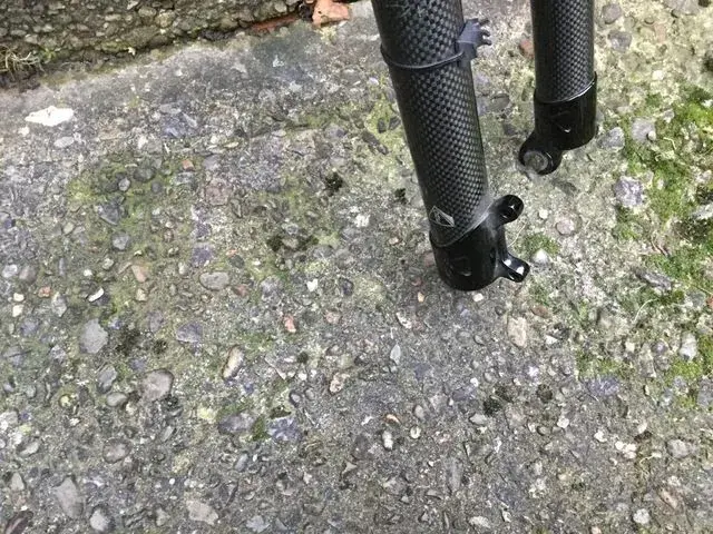

I just bought a carbon fork off here.
The fork is the IS fitting am I right ?

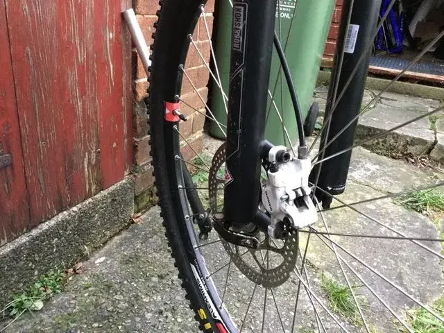

Basically the disc calliper is for post mount as I understand.
So I found an adapter and I am suspecting I need a bigger disc.
The current disc is 160 mm so I think I am in need of a 180mm disc.
I might sound like a total nonce here but I just need a 2nd opinion.

Carbon fork is IS.
Rockshox fork is post.
Brake calliper is post.
Buy an IS fork to post adapter, available for 160, 185 and 205 mm rotors.
I wouldn't go bigger than 160mm disc on the front of those carbon forks.
A: check the manufacturers recommended max disc rotor size.
B: I can't really see the need for 180mm disc on a rigid fork??
Haven't seen a fork only rated to 160 for years.
The 3 or 4 rigid carbons I've had through my hands recently were all rated to 180 or 185.
The 17 stone bloke that I fitted the last set for will be grateful for 180s.
