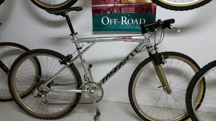

92 Zaskar LE

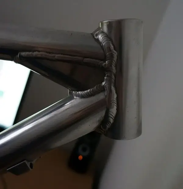

Well,
Here's some close-up pictures of the headtube portion... I see what Kult Friction means, but mine is a bit more crescent shaped than the Zaskar in his picture (a nice one btw!!):
And here's the cable-stop, my 1992 had just one rivet to hold it to the frame:
