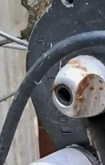

Retro 1992 Diamond Back, sold from a Nottingham dealership as an Axis prototype. The material is alloy, rather than the True Temper steel that was more normal. A very tough frame, it had a 1 1/4 evolution headset, but now adapted for 1 1/8 suspension forks. The bottom bracket is an unusual press-in bearing type, seen on some early Kleins. Bearings are readily available in a standard size. Wheels have bombproof Mavic D521 rims. Disc brake front, caliper rear. Currently runs a 1 x 9 gear setup. A good retro project, or cool ride around bike. Some paint chips expected for age, frame is sound. Might suit a collector. Pick up only please.

If anything it would be earlier, which would match up with the evolution and pressed bearing of other early Alu frames.
Diamond Back had a full range of Aluminium bikes in 1992 and they ae not in that style.
You can see the start of the serial on the stay T0...
Good spot! Hmm, that's interesting. All The T## numbers I know of are steel frames with the stamp on the BB shell and a two digit year code, so either it's a different factory or completely different format for aluminium frames. Any insight @sam_white ?
