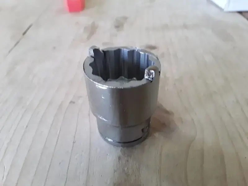

Made my tool out of a £1.99 el-cheepo 21mm (if i remember) 1/2 scocket and an angle grinder. Its done over 20 years service so far!

You will need to put the body in a vice to get it undone....they are tight! But keep an eye on the pressure..the body will shatter if you crush it!
