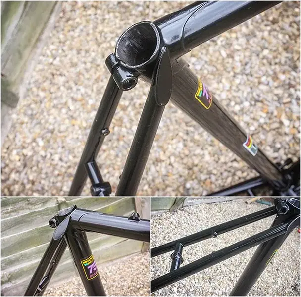

So that explains how it came about. The double eyes on the front and rear dropouts and the 2 bosses at the top of the inside of the seat stays match with the description in the 1986 Raleigh Ilkeston catalogue.

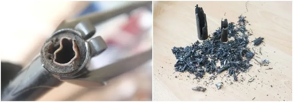

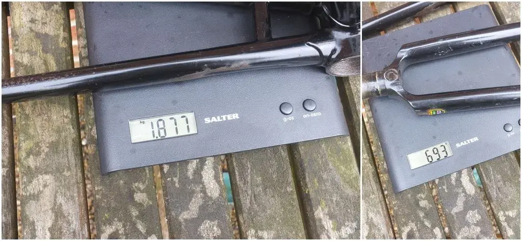

The weight of the frame pointed to it being 531 as it was a little over 2000 grms but it did have 5 inches of stuck seatpin still in the frame.
Lots of cutting and drilling and patience worked to get the pin out. On the scales it weighed in at...
So definitely 753.

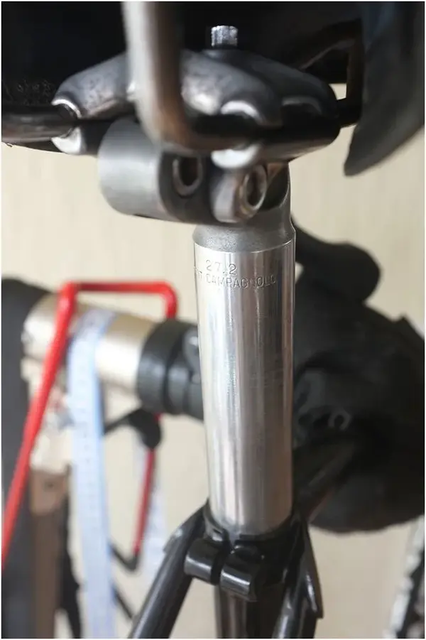

Lots of people get hung up on the size of 753 seatpins. There have been several variants of 753 over the years that it was in production. Not every frame and seatpin is perfect. This frame should be 27.2 as it is the later imperial 753. My Campagnolo Record seatpin which is stamped as 27.2 actually measures at everything from 27.12 to 27.2 depending on where you put the digital vernier. After a quick ream to clean the seat tube, the 27.2 pin fitted perfectly.

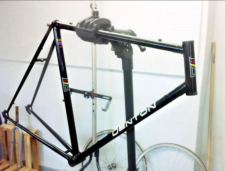

After a good clean up, it doesn't look too bad in it's black enamel paint.
I've built the other 3 bikes and stuck to full matching period groupsets. With this, I'm thinking of a change. I'm going to try and build a really good randonneur/audax bike. So as light as possible but with parts that are as durable as possible.
Starting with a 2Nut Chris King headset and also thinking about Mavic 501 hubs. The rest is still a mystery, especially bottom bracket and gearing. And the biggest mystery is where I am going to get all the money from to build a fourth bike!
