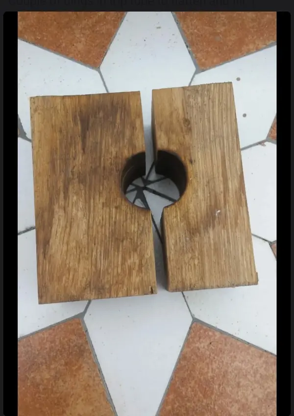

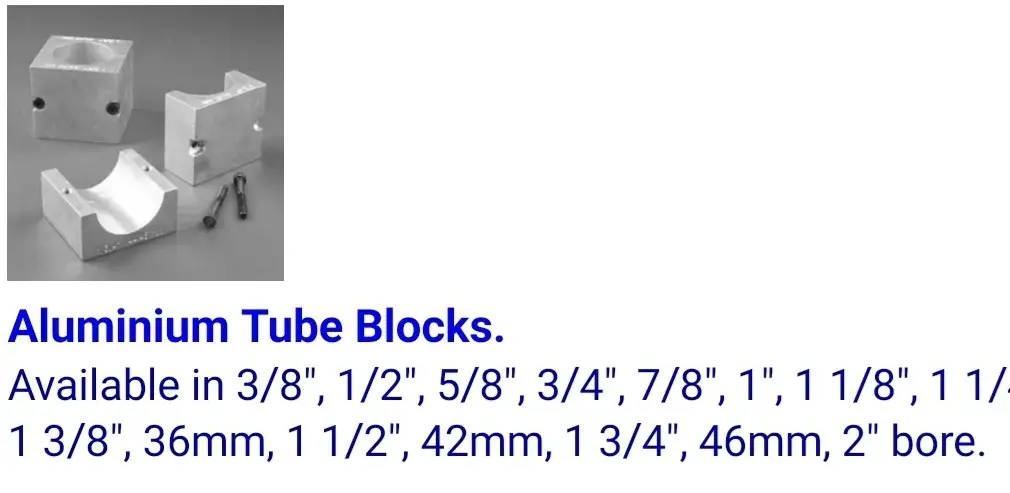

If you want to get the dent out I'd consider speaking to a local good (and I will emphasise that point) PDR guy. I've got a local one here I use from time to time who's excellent and loves all sorts of interesting challenges. A seat clamp on at the top to prevent distortion there and I reckon they'd get that out with very little time or effort.
