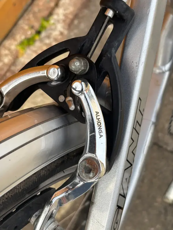

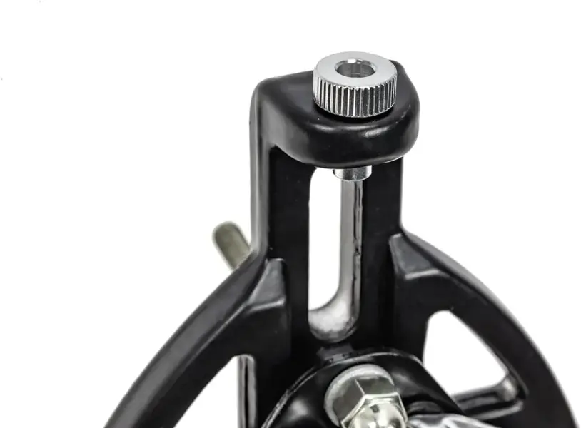

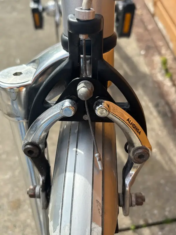

It was suggested based on a not so great picture that the brakes on my 2008 Giant Halfway might have been Rollercams.
I took these pics this evening and it was confirmed they are not.
Front brake
Rear brake

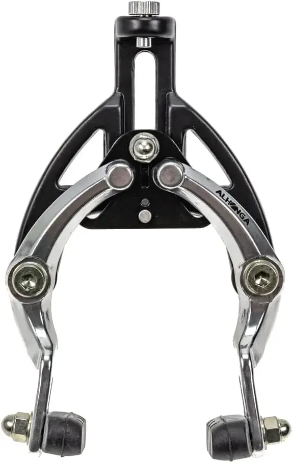

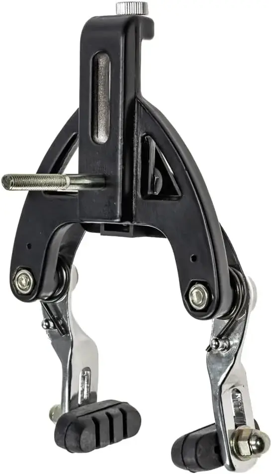

A day of not doing my job and messing around online looking for answers found these:
amazon.de/ALHONGA-Fahrrad-U-Brake-inkl-Bremsbeläge-Faltrad/dp/B09RK5TLN9
About this item
• Alhonga cantilever rim brake, shape: U-brake, position: front
• Leg width: 70 mm, brake rubber length: 40 mm
• Designed for folding bikes. Colour: black/silver. Material: aluminium
radversender.de/ALHONGA-Fahrrad-Felgen-Bremse-U-Brake-inklBremsbelaege-VORN-Faltrad-Klappi
• Cantilever rim brake from ALHONGA
• Type: U-Brake
• suitable for folding bikes, folding bikes
• Position: Front
• Leg width: approx. 70 mm
• Brake rubber length: 40 mm
• with mounting screw
• Material: Aluminum
• Color: Black/Silver
I dont know if its a German thing or its lost in translation but they look nothing like the other u-brakes when I search for Alhonga u-brake
In the same sense they look nothing like the other rollercams when I searched for Alhonga Rollercam brake
I can see the Delta shape of the rear plate that moves the arms, however Alhonga delta brake also brought no results matching them
Both of those sites shared the same 7 pictures as below and they were pretty much all I could find on these brakes.
Tomorrow after work Im going to tear the front brakes apart to show the individual bits as this is quite a puzzle
Front brake
Rear brake

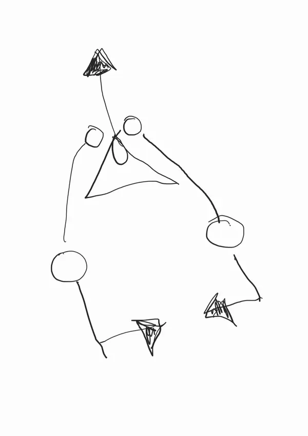

Basically it works as a roller cam, except the edge the arms are actuated by is a slot, and the rollers are just pins:
- this will increase friction and wear, but the designers will have considered that acceptable.

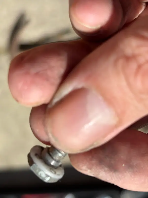

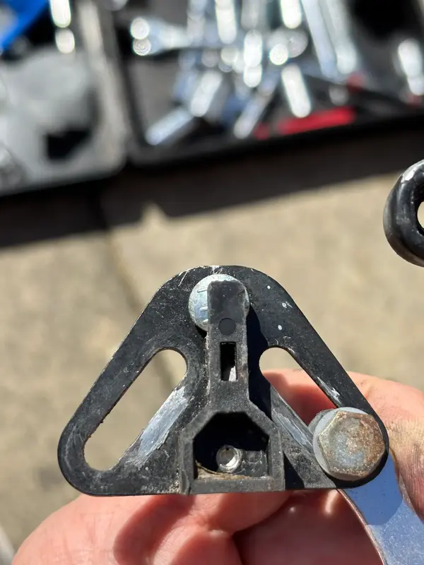

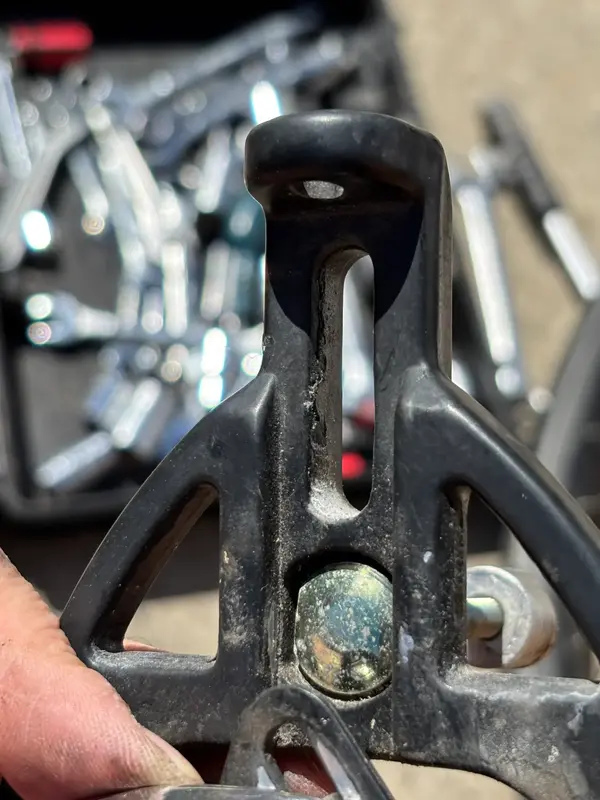

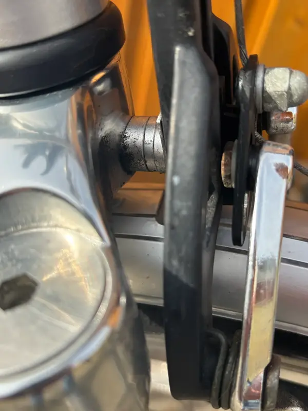

Sorry Tom, I forgot to upload these.
The carrier frame showing the slot the delta bracket type thingymajig* slides up.
(*now called delta bracket below)
The rear of the delta bracket showing the bolts that connect to the brake arm (well one of them anyway) and the guide for the above guide
The bolt that connects to the carrier arm has a PTFE tophat guide which rides in the slots of the delta bracket.
All in a rather simple system once I figured out how to take it apart.
