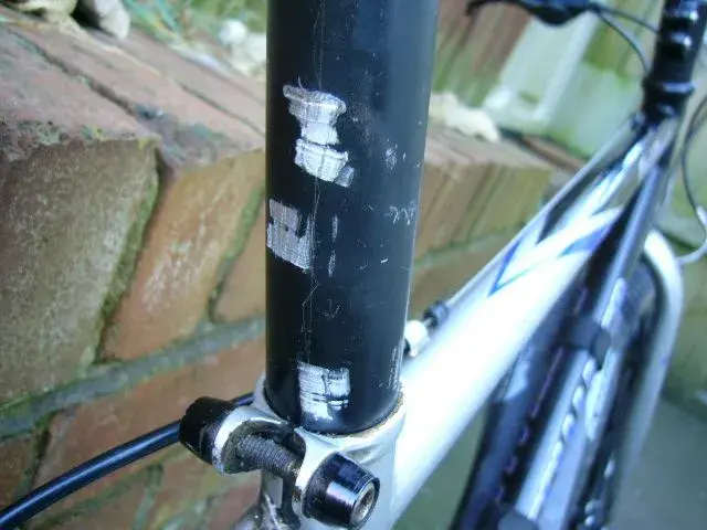

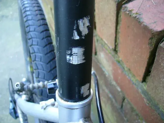

THE ANSWER IS NO !!!
I don't have the luxury of a blow torch, vices etc and i have very little patience with this kind of thing :twisted:
In the end i gave it plenty of penetrating oil, some time then attacked it with MOLE GRIPS. :oops: This is the result....

sounds like a visit to a shop is in order then! phone a couple and ask for an overview of how they'd do it first, find someone who does it properly and not the bodge ways, seatposts are cheap, frames aren't! try and get them to say "we've never been beaten yet!", i haven't and that's what i always say to reassure customers.
good luck! :D
also, take the whole bike, they'll remove bits as they need to to get at it but it's easier to start with the bike in one piece. if it's just a frame they'll have to clamp it in a workstand and they won't beable pull on it as much!
I've been giving the seatpost my meanest look, going to get medieval on it later !!
Ill be in touch when it's out !
