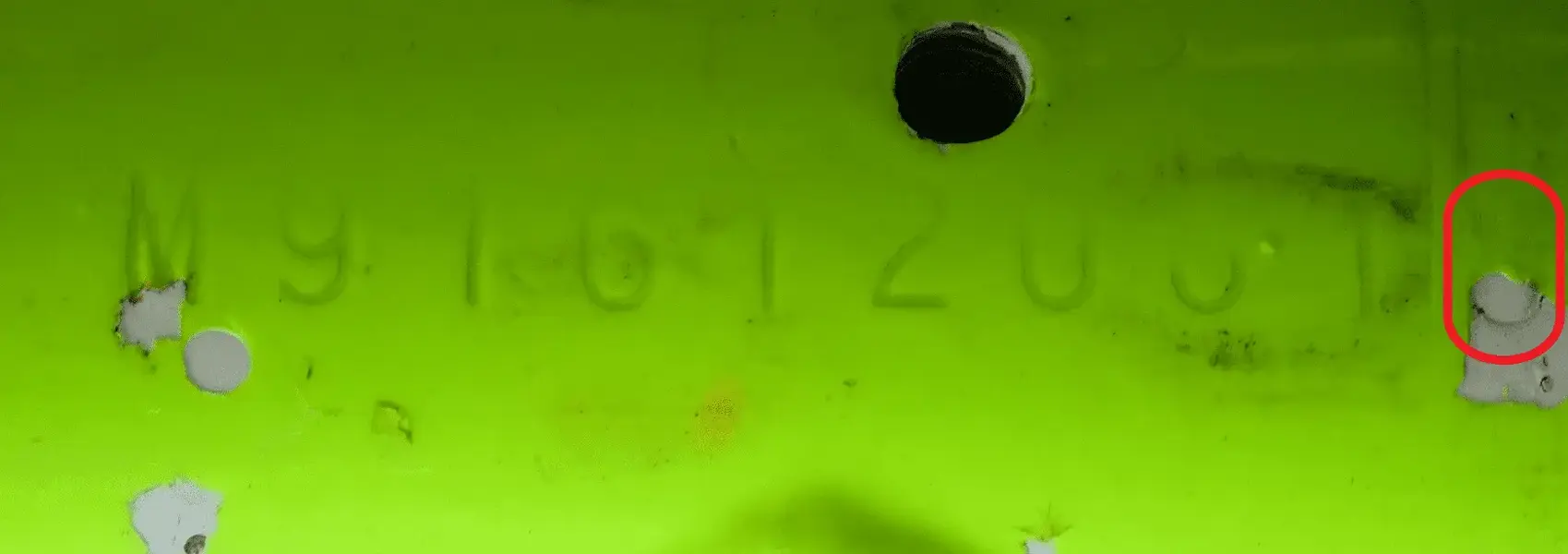

The frame number also appears to have pre 1991 characteristics, ie 10 characters - one letter followed by 9 numbers, assuming that last mark is another poorly stamped number (6, 8 or 0?), and yet the year indicates it was made in '91.
So if it is a 91 frame, and that last mark is just a remarkably number like dent, and therefore the frame number has only 9 characters as per pre 1992, where are the letters? And why were they making 1990 spec bikes in 1991?

UK, I bought the bike from the original owner, also in the UK. He said to me he believed he got it in 1989, but didn't seem completely certain about that, just to throw more mud in the water 😁
Right now, I can only expect it's a 1989 (put for sale 1990) and the other numbers dont mean a great deal, I expect, frame size, etc....hidden there.
Tootyreds' pre 1992 still fits for your bike as letters are involved, thus eliminating as 1991.
Your code is one letter, then all numbers.
My cash (20p) is that you bike is 1989.
I do agree that extra code deciphering is needed for that year.
