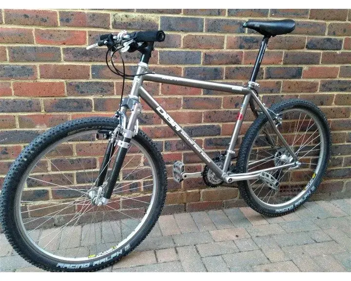

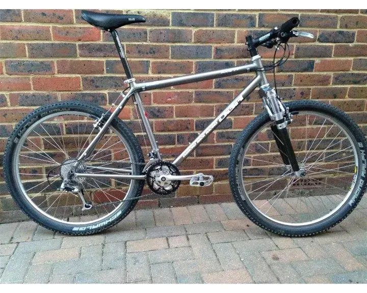

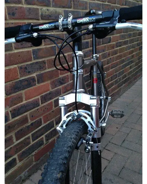

DBR Axis TT - retro reboot (pics on Page 4)
Just need the tyres now....
Frame: 1995 Diamond Back Racing Axis TT - titanium (18”)
Fork: Pace RC35 MXC
Headset: Chris King
Stem: Ritchey WCS
Handlebar: Controltech Carbon
Grips: Ritchey WCS foam
Brakes: Shimano Deore XT (M737)
Brake Pads: Shimano Deore XT (M737)
Brake Cables: Shimano Deore XT
Brake Levers: Shimano Deore XT (M737)
Shifters: Shimano Deore XT (M737)
Front Derailleur: Shimano Deore XT (M737)
Rear Derailleur: Shimano Deore XT (M737)
Derailleur Cables: Shimano Deore XT
Cassette: Shimano HG-41 11-32
Chain: Shimano HG70
Cranks: Shimano Deore XT (M737)
Crank Bolts: Shimano Deore XT (M737)
Chainrings: Shimano Deore XT (M737)
Bottom Bracket: Shimano UN52
Pedals: - DMR V8 (temporarily)
Hub Skewers: Shimano Deore XT (M750)
Rims: Mavic XC717
Hubs: Shimano Deore XT (M752 / M760) – ti axles
Nipples: DT
Spokes: DT Swiss Stainless
Tyres: Schwalbe Rocket Ron
Tubes: Kenda Super Light
Saddle: Ritchey WCS Logic Titanium
Seatpost: Ritchey Pro Carbon (27.2 mm)
Seatpost Binder: Diamond Back
Weight: 22.88lbs (excluding pedals)
I will buy another if they had any x-large frames but I don't think they made any, I just can't ride the smaller size since passing 50!
