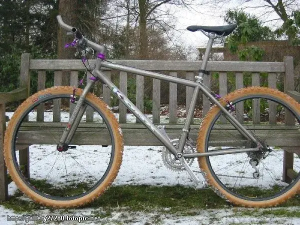

But I suspect this is a 92 Hei Hei, as I've also seen a 93 Hei Hei with a short seat tube extension and the 93 spiral was bright green and purple. I know other 92 Konas had a K on the head tube, but I believe the 92 Hei Heis and Hots were the first bikes to have the spiral. Also the K on the seat tube looks 92ish to me.
If this is so, the geometry was designed for a 40-50 mm fork.
I don't understand the serial number format, so I can't tell anything from that I'm afraid.
I think you'll find its not as early as that, the give away is the bullet dropouts which appeared in mid/late 93 for MY94. MY94 was released around August 93 from the 93 mags.
Assuming the seat tube decals are original, they also date it as MY94 (or 95) which was the first year of the kona Thumb logo.
It's true to say that most 94-96 Hei Hei frames had shorter seat tube extensions but there are exceptions out there. the 94 catalogue bike for example has bullet drop outs and a normal Kona length extension.
Serial number E19xxx is more likely B19xxx with the B poorly stamped (or read) and the frame size 19 which it is from the the photos (head tube length etc etc). xxx is the frame number in either the production run or the size but I've comflicting information on that.
Down tube decal is close to a 97 Hei Hei one, but a little of the dark side and is also in the wrong spot too close to the head tube.
Anyway thats my $0.02 worth ;)
Yes, I was shading towards a non-standard 94 in my later effort, although I still have difficulty taking in this apparent fact that the same factory would build bikes of the same name for the same client to two different designs at the same time. Why? But then we also don't know why they went over to higher top tubes/shorter seat-tube extensions either.
What year would you say this bike was? Believed by owner to be 93 and everything correct for 93, but it has bullets and a high top tube.
