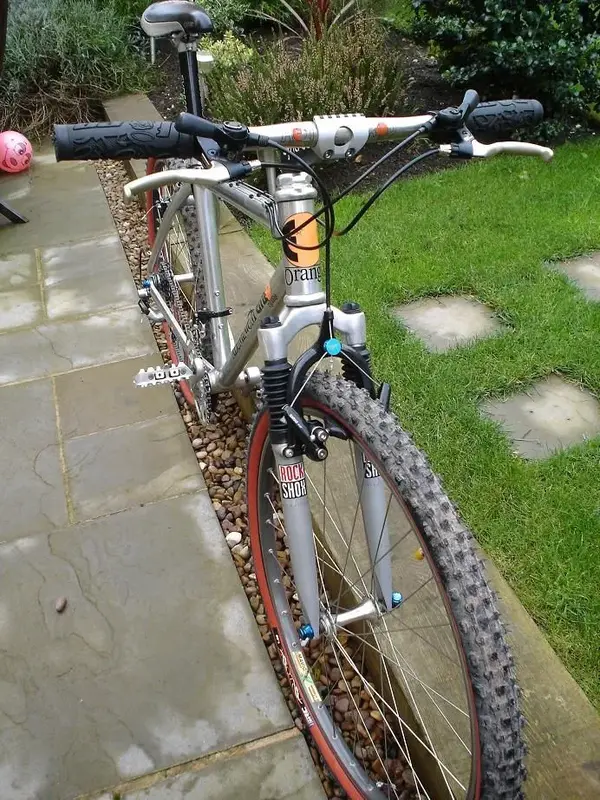

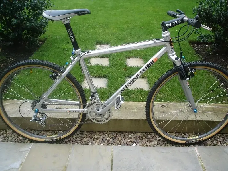

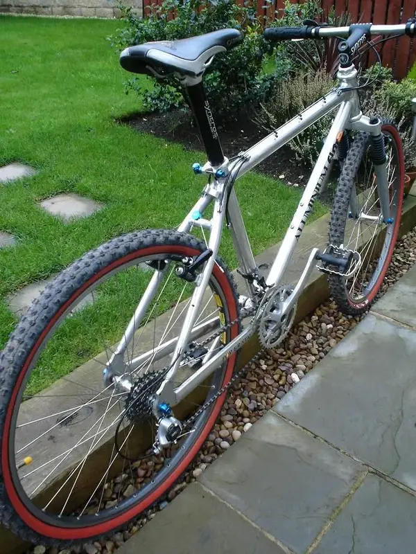

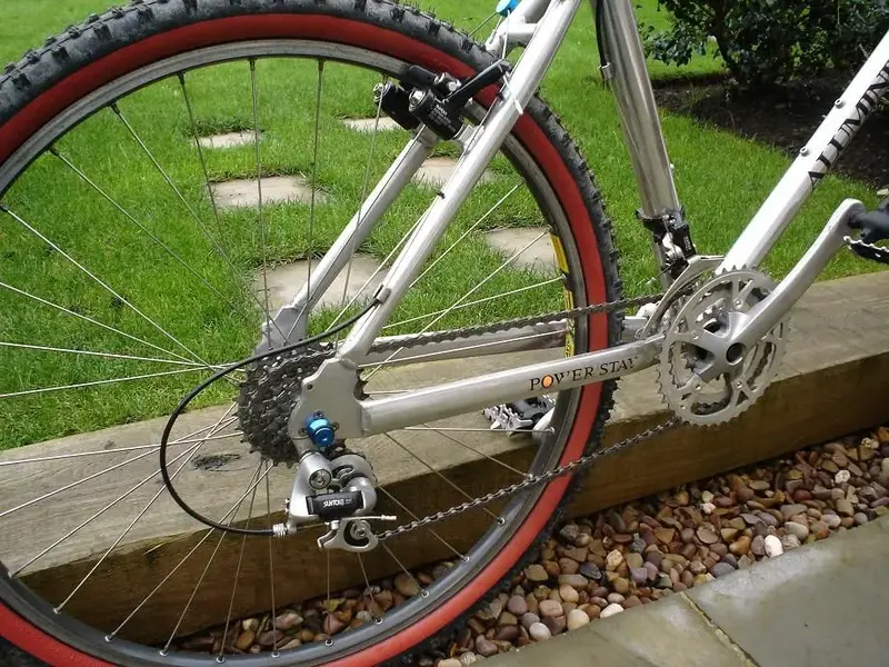

Syncros stem now sorted. Got myself a shim from here......
http://www.ukbikestore.co.uk/Product/55 ... shims.html
To get a 1 1/8" quill stem in a 1 1/4" steerer tube I needed a shim with 28.6mm inner diameter and 31.8mm outer diameter. Closest one they did was 27.2 (id) 30.4 (od), which had the correct 1.6mm shim wall thickness. Gave a really good, tight fit.
New pics follow below......

Very nice - that stem makes the world of difference. Now how about some orange grips and toeclips with orange straps?

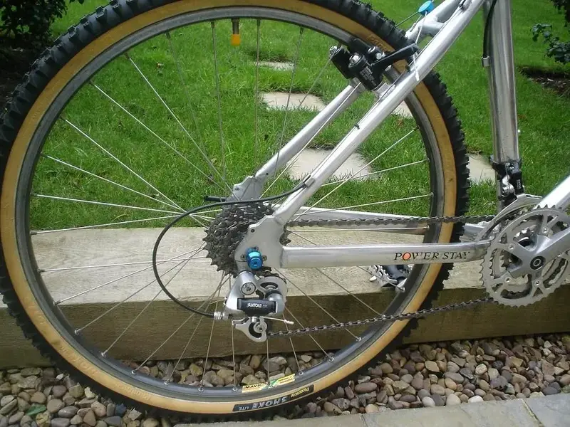

What a difference a Smoke makes 8) :wink:
Panaracer Smoke Lite - as I rode BITD.
Dave
