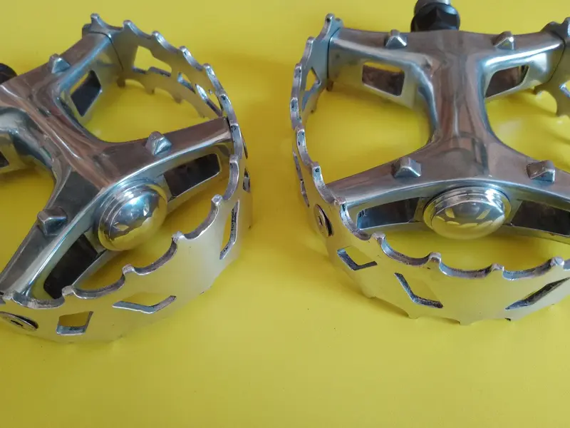

We have peddles.....

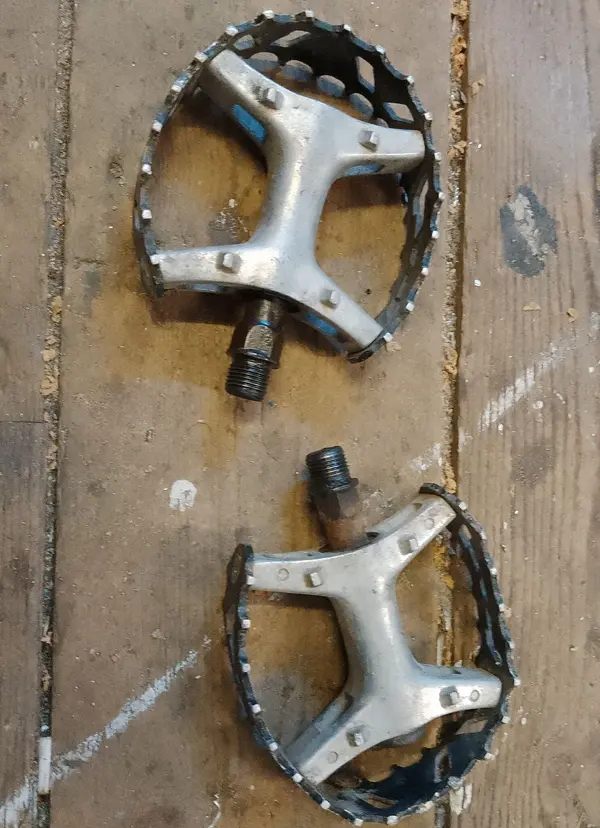

So this morning strip the paint off the cages...what a chore 🙄
Beat em around a bit and back in to shape they are! Wet flat and a polish and looking shiny shin vicious 😁
This afternoon some reprofiling of the bodies a polish and a buff then retapped the threads for some nicer stainless countersunk bolts,
new bearings and they're spinning like a top ✌️

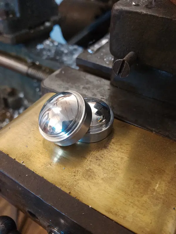

Not a problem ...so I got Mr Winfield the lathe out of retirement and got him to rattle some little aluminium push fit caps out...he's a good old boy turned out lovely...
And popped em where they belonged...
Jubbly 😁

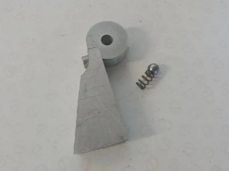

Cable track/groove and nipple housing done...
Slight cam action to reduce throw...👍
A bearing and a spring awaits....clicky clicky very tricky 😆 that bits going to be fun....

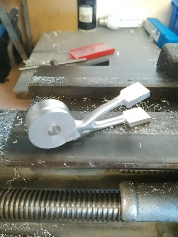

Let's deal with the ergonomics first.....
Thumb action and index finger action....small petite light and hopefully as unseen as possible under the bar....well that's the idea anyway!

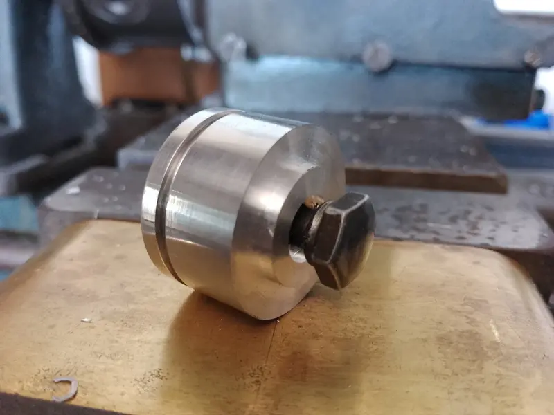

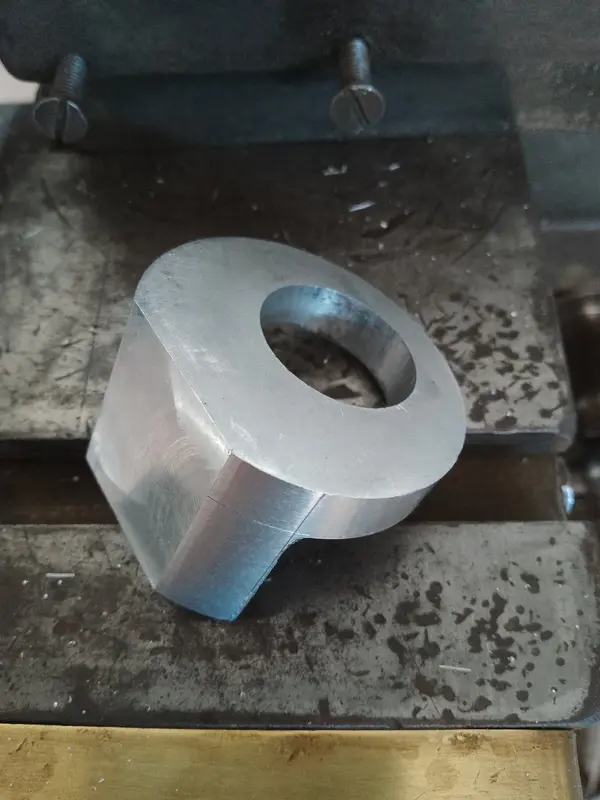

New improved cable track for a much better fit no cable squirm gonna happen in there!
No cam action...bye bye...bigger diameter that'll give more pull for less push.
And found a much better bolt ....with a nice little extra register under the head....there'll be no slack or wobble in this shifter 👍
And a start on the clamp/mount....might hear some clicky sounds tonight 😁
