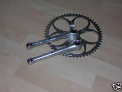

Hi, I just bought a crank, of of Ebay, it's supposed to be a tune, the person had it listed as a mtb/crosscountry/ road crank..
however this crank does not fit my mtb's (tested it on all of them), it's too narrow, i'm figuring now its a road crank, and I'm beginning to wonder if its indeed a tune, can anybody verify this?
It used to be purple, it takes 110mm blades, an has an option for tripple, it's got indentations on the sides of it, and the back-end of the pedal thread is closed. attached is the picture of te seller, it came wit a 54tooth blade, which should have rung an alarm bell..

it does not look like tune, need closer pic's, it looks like TOPLINE, if you check my thread a few threads down from this one ull see a set i refurbed, check for any cracks. if its mtb the bcd will be 110, think road will be 130?
the bcd, is 110, it sure does match the topline style very well, only difference is the spider, the new spider arms have got rounded ends, this one has got square ends with a small radius. They are quite light 378 grams without bolts or chainrings, have to get a new bottom bracket now
No cracks in them btw
what would be the BB spindle need to be for a 73 mm bb?
I would say Topline too. They did a number of different spider configurations for MTB and road.
Topline, just need a longer BB axle I think. Something in the region of 125mm +/- 2,5, depending on frame clearance etc.
topline or first gen. grafton. these are definitely not road cranks as the road ones had 130bcd. these are definitely not tune ones as they look quite different.

do you have a close up pic of the early graftons? what differs from the topline?.. I suspect I have just acquired a early set of graftons..
