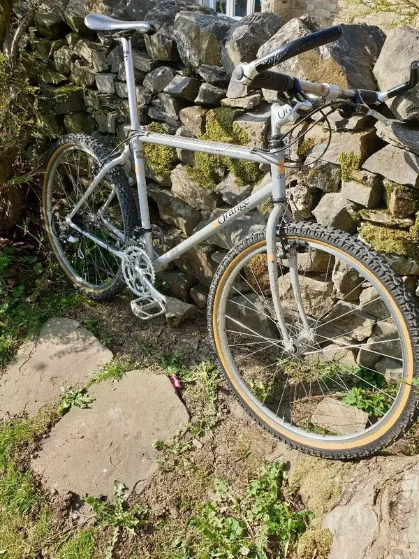

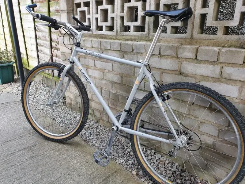

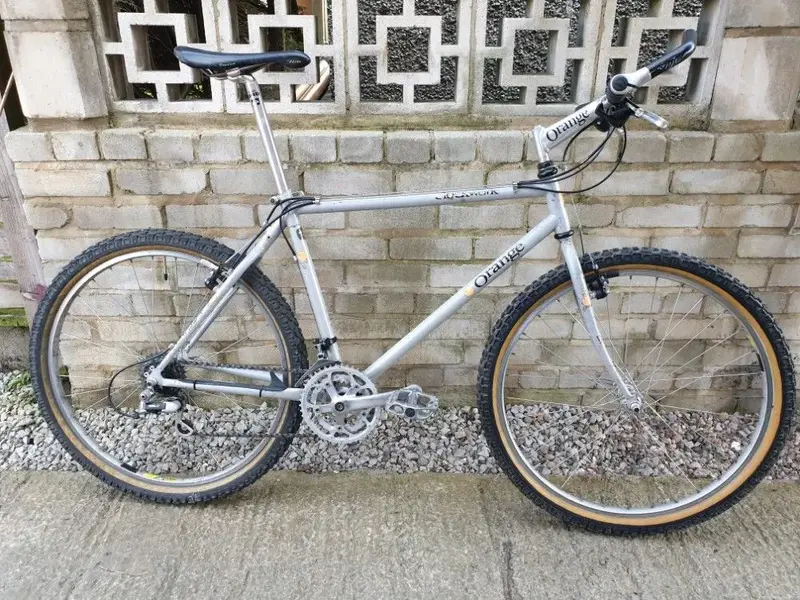

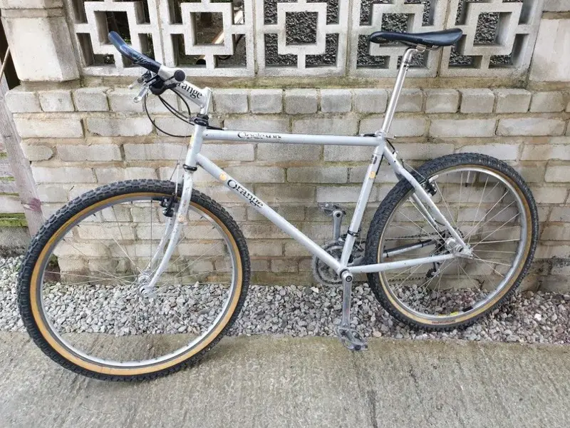

Maybe it's just the pictures, but isn't that front mech wrong? It looks like a bottom pull mech where you need a top pull mech?
Cheers dude. 8)
Been tinkering today. Seem to be struggling to stop the rear mech from fouling on the largest rear sprocket but getting close after shortening the chain. With the wide range front rings and short cage mech I think I have to accept I won’t have a full spread of gears.
In better news I sorted the shifter. Turned out the cable had got caught in the wrong bit of the shifter due to it being old and baggy. Works now. :D
Unfortunately a mixture of stiff front mech and a pulley that hasn’t moved in years and won’t unscrew due to being corroded in means front shifting is worse than the terrible rear atm! :lol:
So a good soaking of GT85 overnight seems to have freed the mech and pulley enough to get them working! :D
Bit more tinkering today and I reckon it's about done except for tidying the cables. Not bad for a box of unwanted bits bike in my opinion. Best thing is that after a quick spin it doesn't feel too small set up like this. Compared to my modern saddle the Flite feels sweet too so might need to pinch it.
