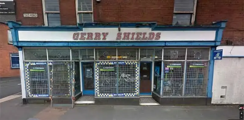

There is one near to where i work ... Gerry Shields.
Spoke (see what i did there) to a really nice chap on the phone and arranged to drop the wheel in Monday Lunchtime ... no jaffa cake deals but £10 to true a wheel 8)

Hows this for a blast from the past ... proper old school ...
I haven't been to Failsworth for more than 15 years, that shop has not changed! As you say lovely bloke, but never had much to appeal to the Enthusiast, hard to believe he still makes a living.

Decan":gjs5ahgc said:
If only the bikes inside were as old as the shop looks ha ha
Great photo
Sadly they are not. It's surprisingly big in side ... Well stocked too though of little interest To most on here I would imagine.
Shop looks exactly the same as in the pic above. even has original stained glass window panels ... I guess like many LBS they are just about keeping heads above water and can't afford fancy shop fronts.
